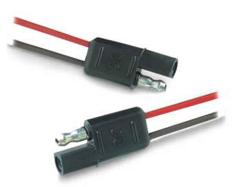

The "Zamp" plug on the POD is nothing more than an SAE connector with #10 wire that runs directly to the battery. The Zamp set up is nice, if you want a plug and play quality system. If your into DIY and you like a challenge then designing your own system will allow you to create a solution to fit your specific needs. Oh, BTW, that is the first step...Identifying what it is that you wish to accomplish with your solar system. That's where all the real work is, determining the specifics of your power requirements and power use plan, then trying to create a solution that will replace your power consumption. This goes on going back and forth, adjusting your specifications to match hardware until you have a reasonable compromise. I use a 50w Renogy Mono Crystalline Panel with a 10amp solar charger bolted to the back. I use the setup at the beach in the Gulf of Mexico and have great access to good sun rays all day long with no trees or other shading obstacles in the way. I expect to achieve 20-25 Amp Hours of charge per day.  The sky is the limit, good luck and please come back and let us know how it works out.

Zamp panels seem extremely overpriced for what they are IMO.
And previous poster is correct, the 'zamp' connector is just this, which isn't special:
