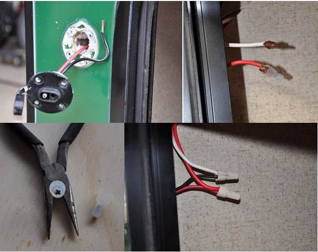

I just put a meter to measure voltage at the Zamp plug and it's dead. I know for sure the wire is attached to the battery and I know for sure the meter works properly, and I know for sure I make a connection because I used a wire probe after the SAE connector failed. The reason I am testing is to establish a circuit for solar recharge while dry camping and I was thinking of using the zamp connection  to connect my charge controller to, I mean after all, that's whats its for. Fuses and breakers look good so I am left with the assumption the wire is open.
Am I missing something?

The next thing would be to check the continuity of the solar plug wires back to their battery connections. I do not believe that wire is fused, but do not know for sure.

Yes   check continuity of each wire from plug to battery.  You have a break or pinch somewhere…..

Found the problem. The Forest River Employee that made the connection did not know what connector to use and the wires that are connected directly to the battery were dangling around in the back panel. Yikes! Clearly whoever used the connector that failed had no idea how to do it properly and should have never been working on the line. What's really cooking my noodle now is I wonder what else this person did on my POD. This isn't the first bad connection I have discovered, but this one is the most dangerous. The connector used was not even a wire nut, it was some kind of small wire like 16 or 18 gauge crimp on. It wasn't crimped...ridiculous to use such a thing on 2! 10! gauge wires connected directly to the battery. I striped the wires and made the connection using the proper wire nuts. I must say, this one kinda pisses me off.
