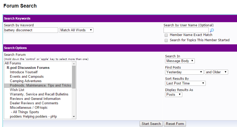

Sounds like it's about time to get familiar with the site's nifty search capability. Click on the Search link at the top and select Advanced Search. Then fill out the form as per the following, and then click the 'Start Search' button. PS: Don't miss the stuff on the right side of the form. You may have to scroll to the right to see it in the image below.
Hope it helps. You'll find a lot of discussion on battery disconnecting and, if my memory's any good, there are some pix of some installs various members have done. Good luck & have fun (searching's fun .. you can find an amazing amount of info on different topics).
