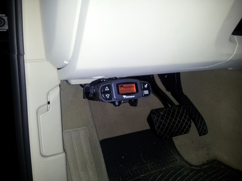

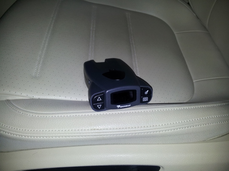

Direct Link To This Post Posted: 05 Oct 2014 at 11:55am
You should take your Tundra to an RV center and have them install an appropriate brake controller if you don't feel up to doing it yourself.
 Since I have owned a 4Runner in the past, I am going to guess that the thing in your glove box is a wire harness for connecting a trailer proportional brake controller. As a reference, I use a Tekonsha Prodigy P3 brake controller, it is very versatile, and can control small and very large trailer brake systems.
 The Tundra should not be towing the R-Pod without a brake controller. It would mean that you would be using the Tundra brake system to stop the weight of the R-Pod. This would be bad for safety, and your truck brake system as well.
 I am also guessing that the Toyota Tundra tow package is a factory receiver and brake controller pre-wired, plus some other goodies like bigger alternator and more transmission cooling.
 You have to purchase the brake controller yourself, there are a lot of different ones out there, but a proportional controller is best, and most adjustable. The R-Pod has electric brakes, but it cannot control when they come on by itself. That is what a brake controller is for.
 The harness supplied by Toyota will be connected to the brake controller (4 wires, easy to do also), and then it will be plugged into the brake controller socket under the left foot well (typical for vehicles with a tow package). Mounting the brake controller is your or an installers responsibility. My old 4Runner was very easy.
 Again, trying to tow the R-Pod without using it's brakes, unsafe on the highway, I wouldn't trust any vehicle brake system to stop 3000 pounds extra from highway speeds.
