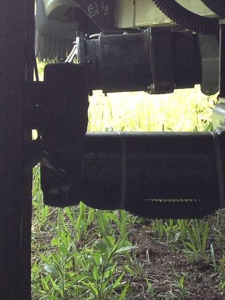

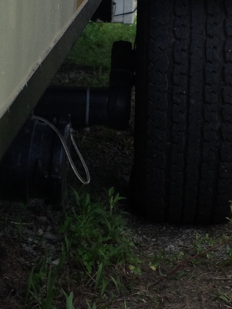

Direct Link To This Post Posted: 23 Jun 2014 at 5:16pm
Ok. Took another look. All lug nuts are torqued so that is not the issue. Towed the pod for a short distance without the WDH ( used a standard hitch) and the same results. What I saw was that where the axel usually moves to absorb shock is not flexing. In fact I think that both sides are sitting in a fully flexed position. Will post a few pics in a few. Please let me know if yours are as such or sit in another position.
Thanks
Front View
Rear View

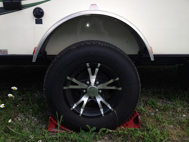

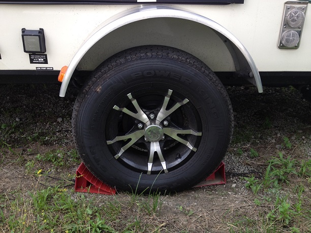

Direct Link To This Post Posted: 23 Jun 2014 at 6:41pm
I forgot to add these photos. Clearly shows the left side tire in a position other than normal. It is forward of where it should be as apposed to the right side tire.
Left side tire position
Right side tire position
Sure looks like the left side tire is a bit forward of the left side tire. The relationship of the tire to the fender makes it seem that much worse vs the right side tire. I know that the one fender is a bit lower but the tire should still be centered regardless. The left tire clearly is not centered.
Has anyone else seen anything like this?

Budward View Drop Down
Joined: 21 Apr 2014
Location: SC/NC
Posts: 438
Direct Link To This Post Posted: 23 Jun 2014 at 6:45pm
Might try carefully measuring from the axle to the front of the frame on both sides and compare.
Seeing some of FR's "workmanship" in other areas I wouldn't count on the fenders or the axle being centered.

sammycamper View Drop Down
Joined: 23 Oct 2012
Location: Minnesota
Posts: 111
Direct Link To This Post Posted: 23 Jun 2014 at 7:39pm
Look at the actual mounting b, rackets that fasten the square section of the axel to the frame. One may be loose and bent. I believe more firmly than ever that WDHs put more weight on the single axel than it's designed to handle.
2012 rPod 173
2008 Trailblazer 4WD V6
Posts: 1238
Direct Link To This Post Posted: 23 Jun 2014 at 7:48pm
   Measure the front or rear of the fender to the front or rear corner of the trailer. They should be equal measurements on the left and right side of the trailer. I agree something looks off center the fenders or the axle.
