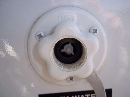

Thank you for your reply. What do you mean "push in the pin"?
Posts: 1004
Direct Link To This Post Posted: 22 Sep 2013 at 4:18pm
Carefully remove the screen and push the little white pin, this is a backflow valve if it wasn't there and you use water from your water tank the water would squired out of your city water connection.

Direct Link To This Post Posted: 22 Sep 2013 at 4:22pm
Thank you. Do I need to do something to get the pin back out when I de-winterize?
Posts: 1004
Direct Link To This Post Posted: 22 Sep 2013 at 4:26pm
No you don't.

Direct Link To This Post Posted: 22 Sep 2013 at 5:27pm
The pin is on a spring; you have to hold it in to drain.  After it squirts the water and then antifreeze out (usually up my shirt  sleeve) and you release it, the pin/valve will reseat itself.
