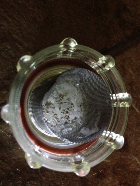

I pulled the filter and there was a lot of plastic in it, but not enough to clog the whole screen.  I cleaned it and screwed it back in.  Then I disconnected the input hose and turned the pump on.  No suction!

This is what the water filter looked like.  I bet most rpod owners have plastic shavings in here!

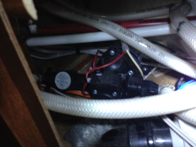

This is what the pump looks like under the sink in our 176

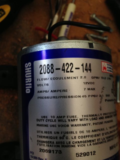

This is the OEM Pump that failed.

It can' hurt a thing.. but I will point out no one has reported anything other than those plastic shavings, most assuredly left over from the build.. once they are out..
