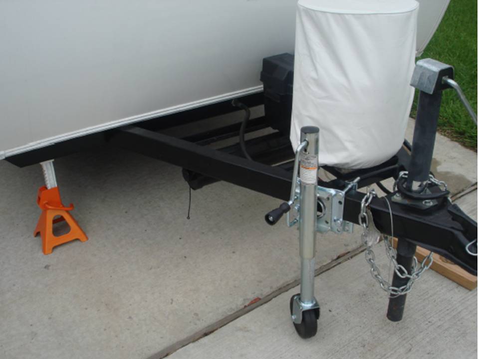

Another question: Do most folks have a wheel for their tongue jack? I'm thinking my hulking teenage boys and I could manhandle it if it did.

I have a swing down wheel jack mounted on the side of the tongue. I got it at harbor freight for $20. Easy to mount and with a little effort you can push it around. Although I don't much because of the sloped driveway  .

I have a long gravel driveway with humps and bumps (read not the kind you back into). I splurged and got a two wheel dolly. It's a little bigger than a wheeled jack, but has 10" balloon tires and is easy to maneuver. My wife and I can move the pod around easily on the gravel.
