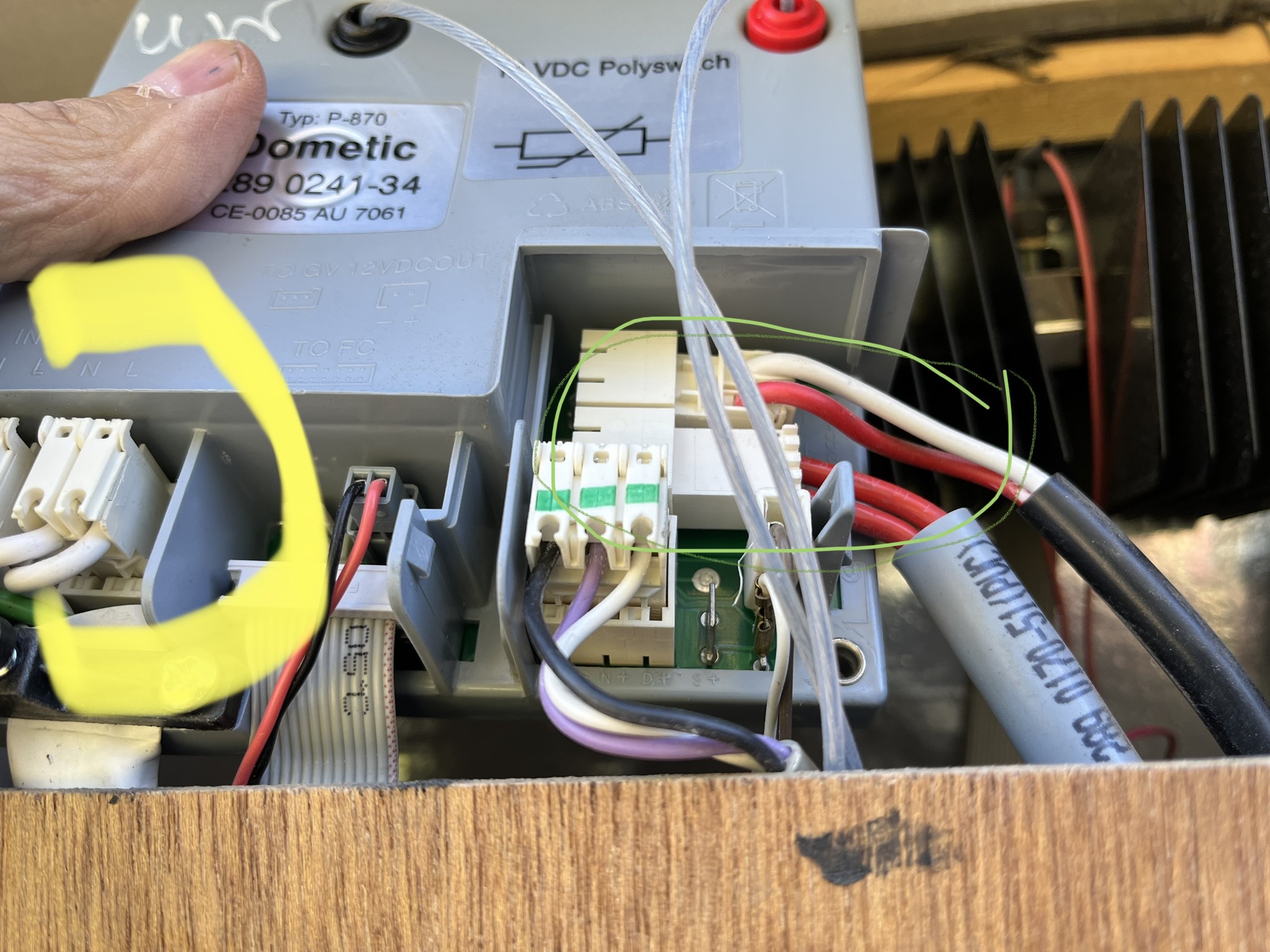

Hi, thank you both. Here is the latest. I was easily able to measure the DC heating element (green outlined connector) and that was 1 ohm. The AC element (the one that could be an issue) is not going to be easy to measure (yellow outline). The connector for the AC element is baffling as to how it gets removed. I do not see any clips and it almost looks like the wires are pressed in. Any ideas?

The circled area shows wires going into a connector. Is the connector something that can be removed? To me, it looks like the top connector in the picture is partially unplugged. That might be the explanation of why it isn't working.

On the connector that I was asking about, It may look loose but it is by no means loose. I have tugged on it, squeezed it, picked at it, etc. I took a break from it hoping I would find inspiration today ![]() Again, thanks for the assistance
