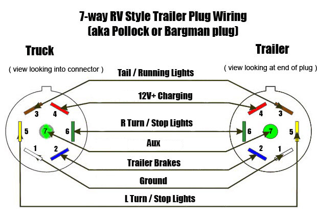

You really can't put a 7 way connector in upside down since it has a slot and raised section that have to mate up to prevent that.
When you have the 7 way disconnected and your 120vac connection disconnected can you clarify what works and what doesn't? That would help in troubleshooting. Of course check all your fuses as well as others suggest. |

Wanna bet? My wife managed to get it plugged in "sideways" so that the brakes came on every time she turned the lights on.
