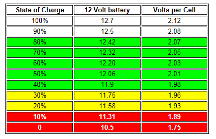

The best way to test the battery is use a meter that shows the amperage(in volts) and then you can also convert that to a state of charge(SOC) percentage.

I know how to read the battery voltage via a voltmeter.  Is that what you are talking about? I'm trying to determine when I'm about 50% down and I need to charge the batteries so I don't hurt the batteries by taking the charge down to far.    I'm planning on doing some boondocking and I don't want to ruin my battery if I can help it.
Direct Link To This Post Posted: 18 Dec 2020 at 10:00pm
50% will be at about 12.2v but you will have to shut off all loads and charging for a half an hour or so to let the battery reach equilibrium and then measure the voltage. Or, once you determine your daily usage is less than 50% you can just recharge once a day, you don’t have to wait till you get down to 50% to recharge.
