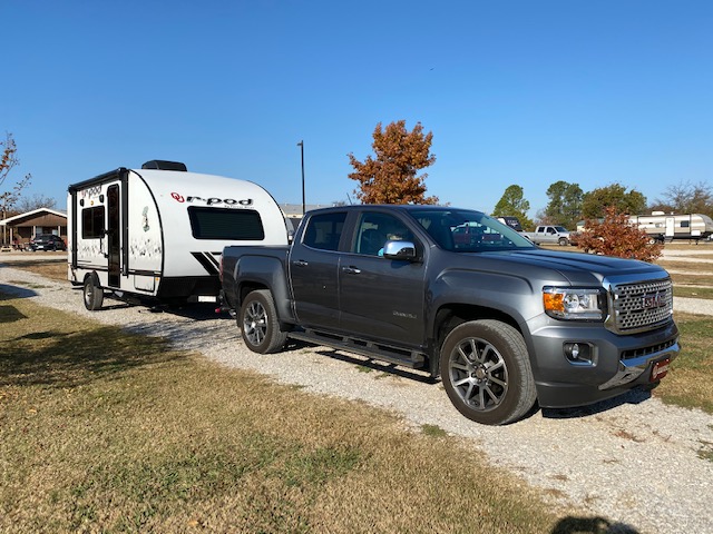

My wife and I recently semi-retired and decided to add an RV to the retirement transition plan having never owned an RV in our 43 years of marriage. After spending the summer looking at a lot of different models and brands we decided the 192 was the right fit for us. We have a 2020 GMC Canyon with the tow package capable of hauling 7000 pounds with a 700 pound tongue weight. We ordered the Rpod back in July and took possession of it the last week of October and finally got to take it out a quick two day trip last weekend. The dry weight from the factory was 3550 pounds with the solar package installed and the factory outdoor grill set-up. The tires were Castle Rocks with a production date of 2220 so not too old. Our plan is to replace them with Goodyear Endurance next Spring.

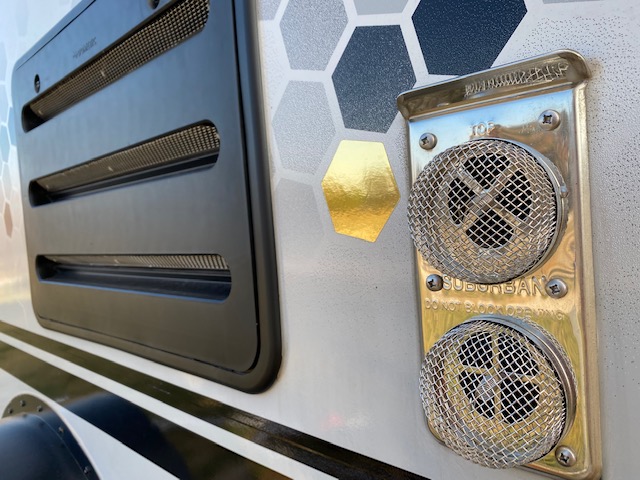

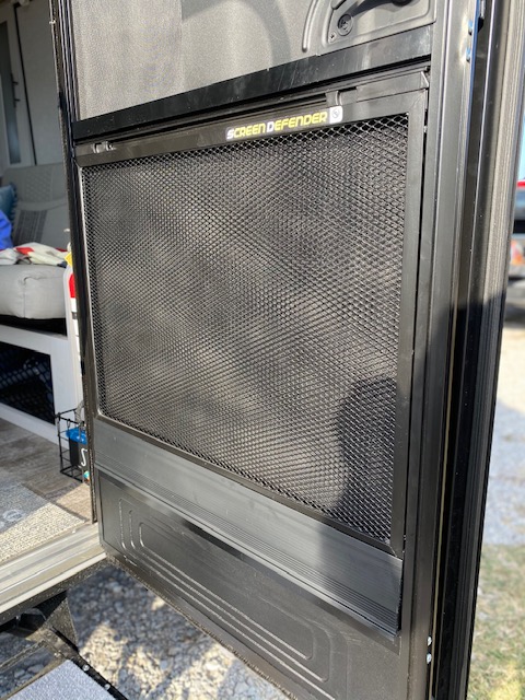

Attached are some pictures along with some of the mods performed prior to our trip along with accessories we installed. Since we had plenty of time between the order placement and delivery we read everything we could and watched a ton of videos about products on the market and filled the garage with items pending the arrival of the 192. Attached are some pictures and descriptions.
OUr rig (being long time Sooner season ticket holders and living in Norman, OK it only seemed apropos to name it OUr r-pod:  Level Mate Pro is mounted on the inside cabinet and worked perfectly:

Lippert Defender Screen Protector so Ruby, the golden doodle, won't damage the screen.
MaxxAir Fanmate Cover- took five minutes to clip into place.

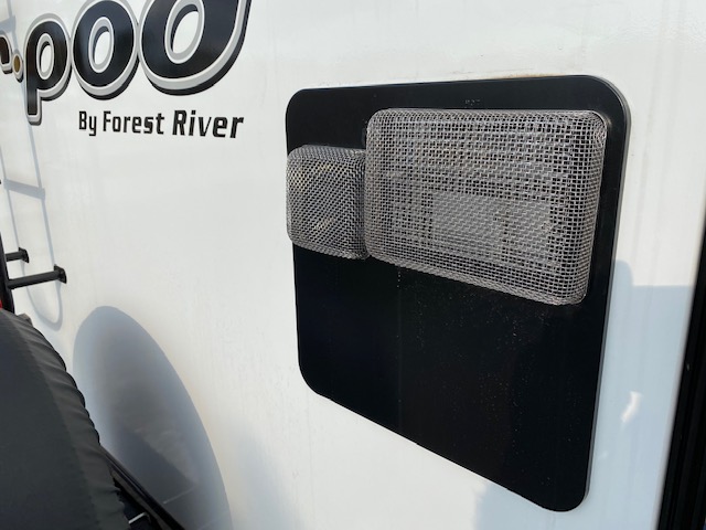

Bug screens all around.

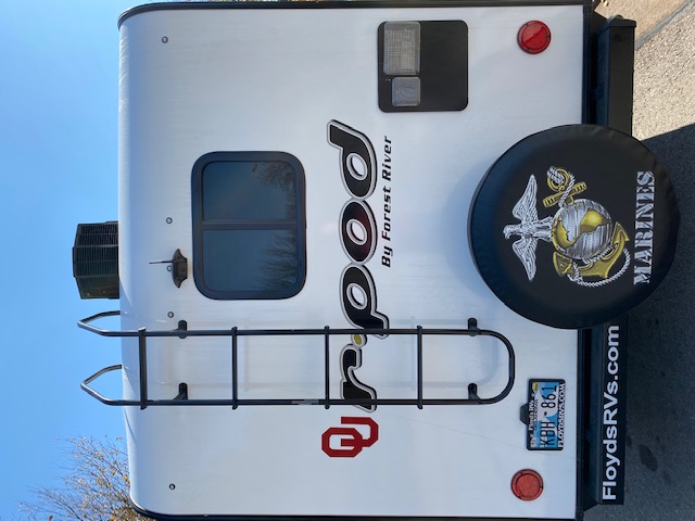

4 inch muffler clamp for security on the black/gray water outlet. Our r-pod came with a second strap that was plastic but I still installed the clamp and it took 15 minutes to set it up.

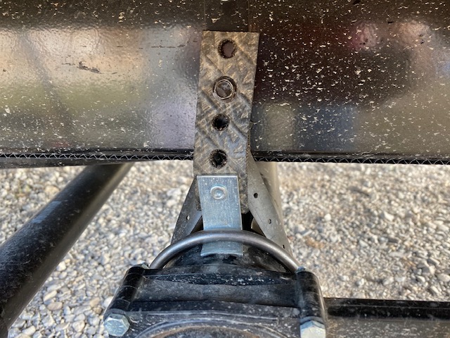

Two wood braces under the sink.

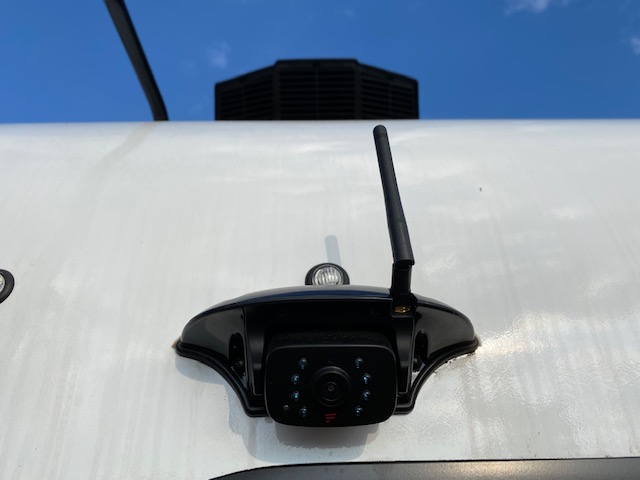

Furrion Backup camera- took 15 minutes to install and set-up and the best piece of gear out there. Worked perfectly and it was awesome being able to see what was behind me at all times. Has a microphone so you can hear, the distance from where the camera is installed to the front of the tow vehicle was not an issue, and it works great at night. Your nighttime running lights must be on since the power source comes from the running light.
