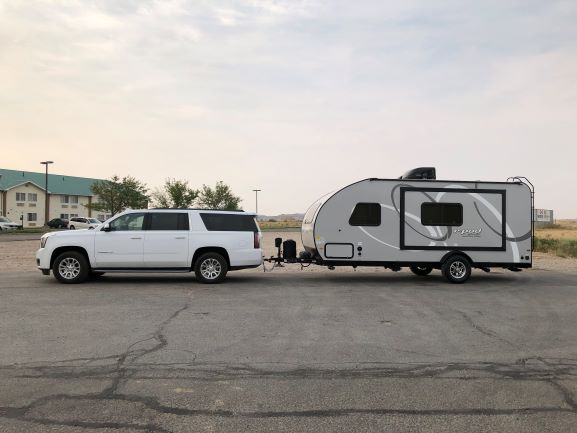

I just bought the same trailer (2021 R Pod 196) a couple of months ago from a RV dealership in Las Vegas, NV. I live in Colorado, and I had to fly out to Las Vegas, rent a 2020 GMC Yukon XL, and tow my R Pod home. It was quite an adventure. Big smile
I thought that I did not need a WDH or brake controller because this trailer was so light (only 3,500lbs), so I only put a 2 inch hitch ball in my travel backpack. Well, I was wrong. Thumbs Down
Good thing, the dealership made me purchase a wireless (Bluetooth) brake controller before they would allow me to leave the RV parking lot (required by NV state law for any trailer above 3,000lbs).
The minute my wife and I left the RV dealership and enter the highway, the trailer started to sway and bounce once we went over 50mph. Since the trailer was so light, I did not even notice that it was swaying until I saw it in my rear view mirrors. Luckily, there was no traffic, and I was able to control the sway of the trailer with my brake controller. From that moment on, instead of going 80mph (NV highway speed limit), we only did 50mph all the way from Las Vegas, NV to Denver, CO. In some areas, we even had to slow down to 40-45mph due to high winds. A 13 hour one-way road trip took us 21 hours to complete. Thumbs Down
Once I got home, I installed my Equalizer WDH (from my old camper) on the new camper, took it for a spin at 85-90mph, and noticed NO sway. I have done 4 camping trips so far, passing cars, campers, and semi-trucks at 75-80mph, and no sway at all (riding super smooth).
The moral of the story: This trailer is super light, but it is also pretty tall. Tall and light are the perfect combination for disaster when it comes down to speed and wind. I would recommend you buy a good WDH system with sway control. It will save you from headaches and troubles down the road.
