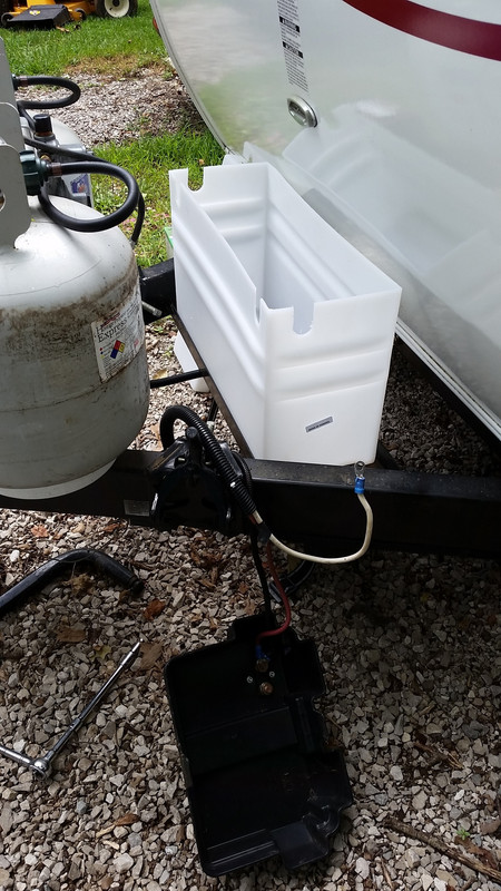

Direct Link To This Post Posted: 30 Aug 2020 at 5:48pm
I use one of these on my 177 to hold two Group 24 batteries:
No need to move anything other than the plastic battery boxes (to the trash).
You can do a search on here and see my pics of the installation

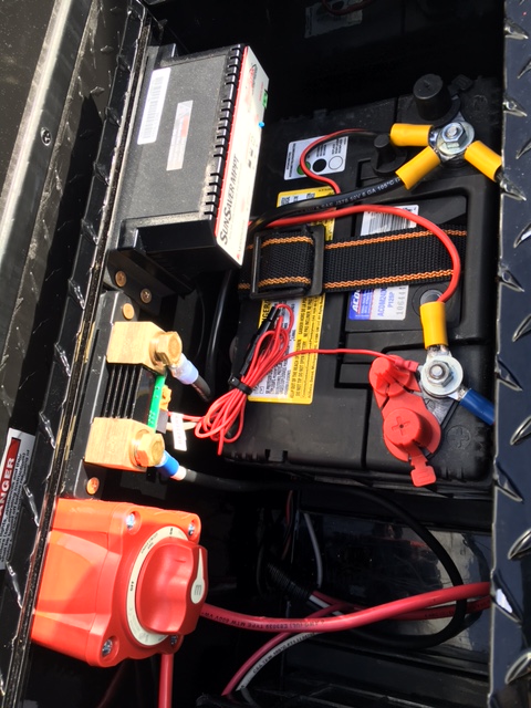

My installation on the 177.
2004 Outfitter Apex 8 camper
2014 Toyota Tundra DC

Direct Link To This Post Posted: 01 Sep 2020 at 10:54pm
Here's My harbor freight Box. I couldn't get to the handle easily, I had to move the tank forward and then with the second tank it worked good because i could just grab the handle between the tanks
