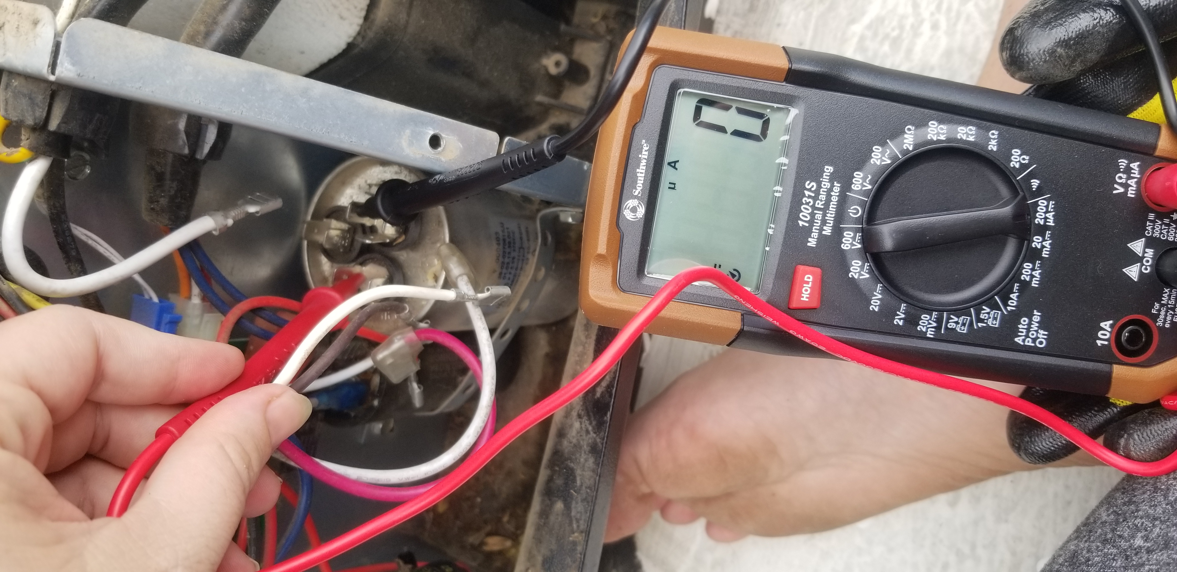

All right. Got delayed by a week of rainstorms. finally got chance to check out the electric. Turned all the power off, unplugged the battery, and turned off all the fuses. I think my capacitor has gone bad as there is a zero reading on it. So I think I just need to get a new one, just don't know where to order one. Also think I'm going to install an Easy start 364. Been reading that they help with the power draw so that I don't just immediately short out the new capacitor.
Direct Link To This Post Posted: 20 Jul 2020 at 6:40pm
Looks like you are on the microamp setting on your meter. That won't tell you if the cap is bad, you need a meter that measures capacitance (measured in micro farads) Also, you need to take the cap out of the circuit when you test it, and short it out first because it holds a charge and can shock you or damage your meter.
Is it the fan cap that you think has failed or the compressor start cap? Or is it the compressor run cap?
If its the compressor start cap then you don't need to worry about it if you're buying an easystart as you remove it anyway. If its the fan cap or the compressor run cap then the easiest way to replace it is to look at the label and get a replacement with the same capacitance, voltage rating, and physical size. They're pretty cheap so you might be better off just replacing them if you don't have access to a meter that can measure capacitance. If any are bulging or leaking then replace them.
You can also call the easystart folks and discuss it with them, my experience with them was that they are really responsive and helpful. The easystart doesn't change anything related to the fan motor I don't think.
