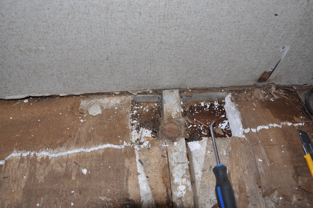

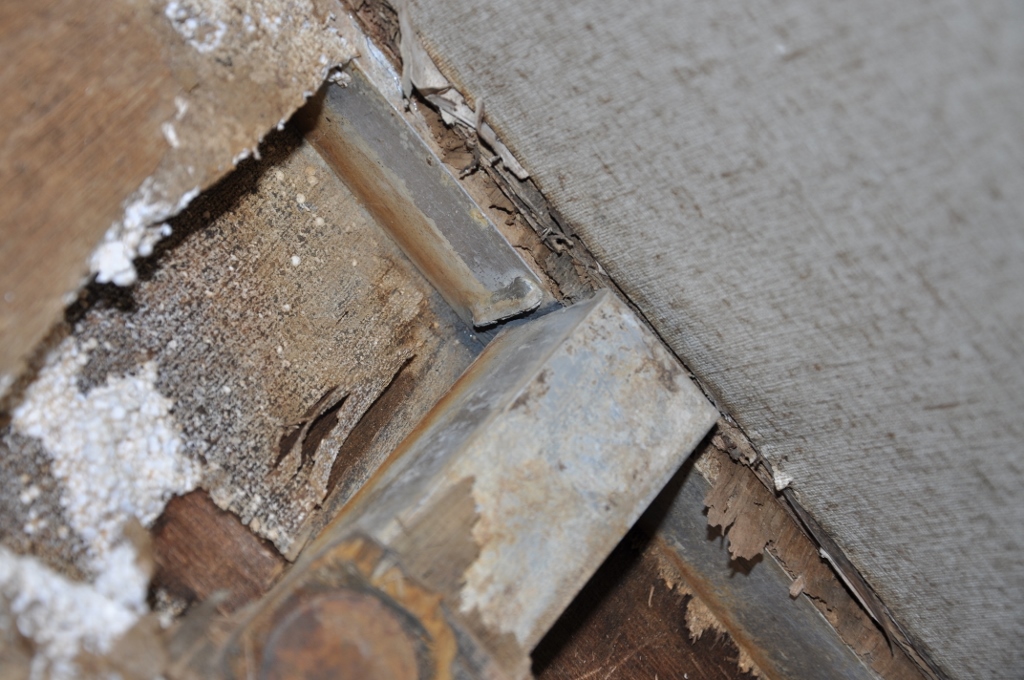

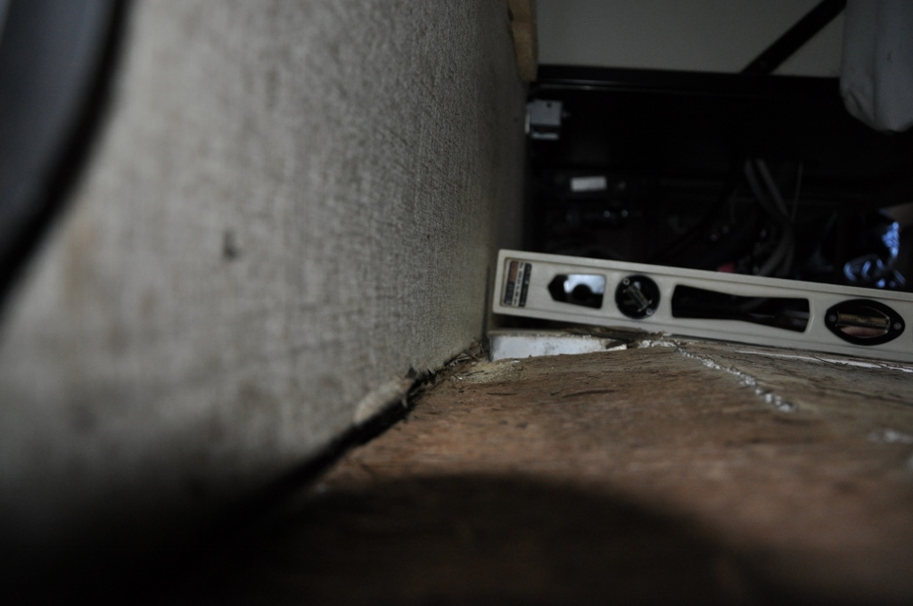

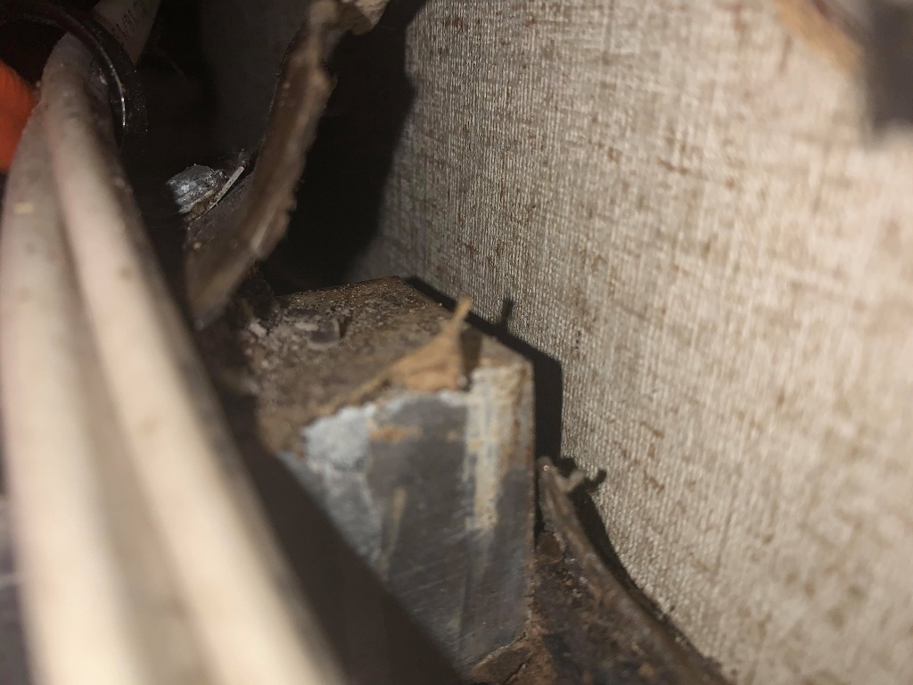

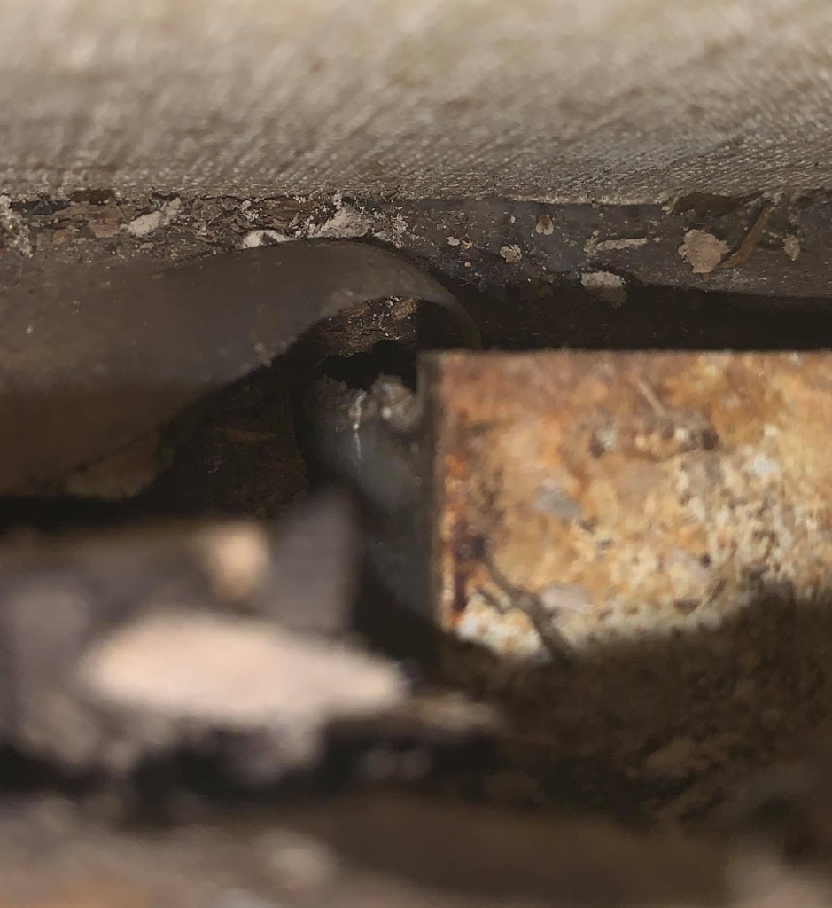

Followup on what I found when I removed all of the flooring. 2 of the floor joists
have broken welds on the slide side, which is t has caused the wall to drop >1". The collapsing floor is a structural issue and the welds should not have broken. Attached are photos of the aluminum joist under the back bed that shows the broken weld and the bend in it on the slide-out side, the same joist on the door side, and the broken weld under the slide side. I believe that the wet floor was the result of the 2" drop in the outside wall - shifting the slide out position and the rear hatch near the floor (won't close properly now). This damage was not cause by me and any negligence on my part. I am seeking Forest River's assistance to repair this structural issue. (first aluminum welding shop has declined repair job) Any suggestions as to how I can get Forest River's attention to cover the cost of this repair? Thoughts suggestions? thank you to all who replied and provided info previously. Belinda 1st 2 pictures are under the slide out. photo 3-5 are the floor joist under the rear bunk on the slide out side. ![]() ![]() ![]() ![]() |

I don't mean to be pessimistic, but this situation looks like, if you were paying for the labor and materials, it would be more costly to repair than the trailer is worth. If you are doing it for fun/recreation with all your own labor and had a cheap source for materials, of course, that is a different matter. I can see why a welding shop declined the work. They'd set fire to the trailer if they tried. I suspect that FR will say the welds broke because of user abuse, not as a result of poor workmanship. Proving the contrary will cost orders of magnitude more than the value of a similar trailer in good condition.

Was this ever used off-road? I don't know what could cause multiple welds to fail except subjecting it to conditions well beyond what could be experienced on average US highways.
