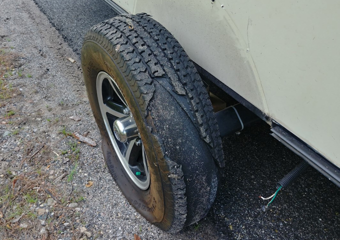

On a recent outing on really the first hot day of the year, I blew my left tire on my 178 after only about 50 miles. Both were checked before leaving. I replaced that one and 10 miles up the road they have 1 in stock, so I was back on the road without the spare. Then about 40 miles from our destination on the same day, the right one let go. I limped into my campsite at reduced speed and got a match for the first tire the next day.
Thing is and long story short, when the tread came off of each tire, it ripped the fenders off of the camper on each side. Not all of the screws were ripped out of the camper, but some were. The wires for the clearance lights that were on each fender were just ripped out of their splices. I have received new fenders from FR and also found the stock factory clearance markers online and have those as well. On my trip to Menards and or Lowes to pick up the necessary screws and grommets that I know that I need for this project, does anyone have any recommendations for the following:

Heading home last summer we had a "china bomb" tire blow out and take out not only the fender but also the grab bar by the door. Our tires had about 7000 miles on them. Fully 80% of the of the tread peeled off of the tire.
There was no double sided tape on our trailer so I cant speak to that.
I filled the holes with butyl rubber chaulk which seemed to work just fine and mounted the new fender with stainless steel self drilling screws.
And yes, there is a a wood panel behind the fiberglass so adding additional screws shouldn't be any problem when mounting the new fender.

Originally posted by jimandclare
I share your pain.
Heading home last summer we had a "china bomb" tire blow out and take out not only the fender but also the grab bar by the door. Our tires had about 7000 miles on them. Fully 80% of the of the tread peeled off of the tire. |
I had some damage to the grab bar foam, but not the bar itself. Zooming in your photo, it almost looks like the same brand of tire? See my other post below.

If I remember correctly from the days I defended some tire manufacturers, on a radial tire, the tread separation you see in the photo is the "normal" mode of failure. As the tire fails, air enters the space between the tread and the plies of rubber coated fabric to which it is bonded. It is not uncommon for the tire to sustain damage unknown to the user which eventually allows air to seep into the body of the tire. Some times, the quality of manufacturing results in incomplete bonding of the tread and with heat, it creates an increasingly big separation of the tread until failure occurs.
I agree with GlueGuy, the best option for the holes is repairing them with epoxy filler with cotton. You can buy this sort of thing at any good marine supply, but with the small amount you need, just some regular epoxy glue and cotton dust or fiber would be fine.

Personally, I would not use a very strong glue to fasten the fenders in addition to the screws. If you have another tire failure, the tread is going to come off and hit the fender, probably taking it off too. If you have a strong glue bond, your fiberglass repairs may involve much more than just filling some stripped out screw holes. It is very hard to see internal damage to a tire, and even harder to detect defects in manufacturing. The best thing buy tires from reputable manufactures who have good quality control.
