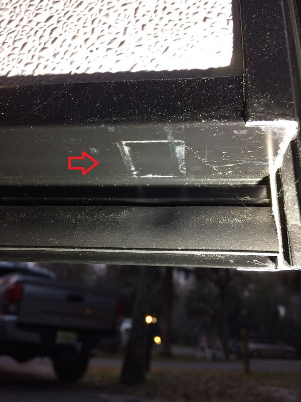

Direct Link To This Post Posted: 19 Feb 2020 at 6:08am
And here is the mark on the bottom of the door where mine was before if fell off:

Direct Link To This Post Posted: 29 Feb 2020 at 6:42pm
Here's the repaired wedge back in it's place. I used Permatex Black Silicone Adhesive Sealant on the back side of it up against the rubber seal where the original clear silicone was, and I also used Dap Rapidfuse on the top edges where it touches the bottom of the door frame. Rapidfuse is awesome, I have used it for so many things now. It's like super glue that actually works!
