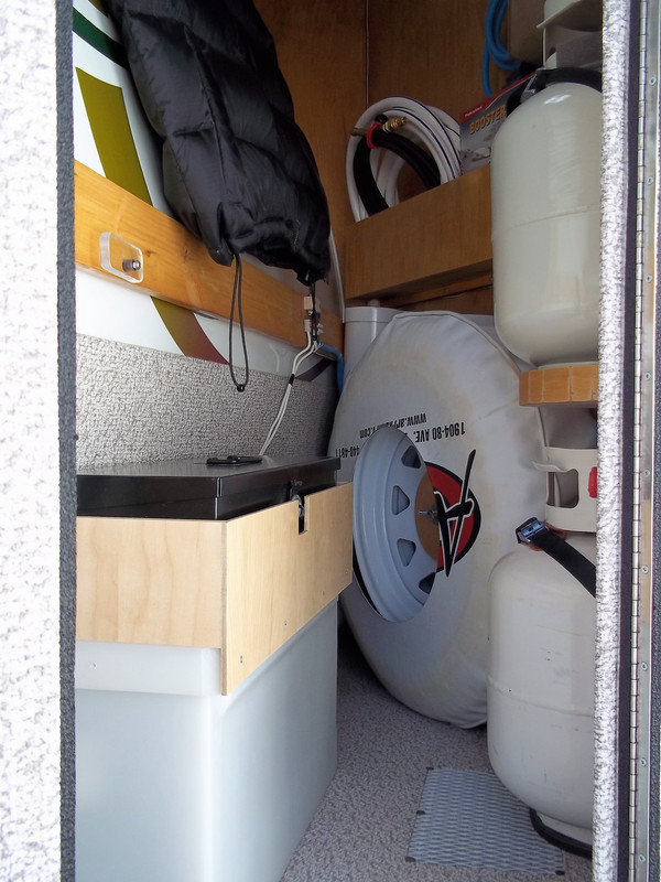

One of the requirements for fire safety (in the States anyway) is for the fire department to be able to get access to the cylinder valves in order to be able to shut them off, so its a fire code violation for RV's to have propane tanks behind a locked door or to have the valves blocked from turning in some way. There are ventilation requirements too. You might never get cited for it but I'm just sayin'....
Posts: 1004
Direct Link To This Post Posted: 27 Feb 2019 at 2:27pm
There is a vent in the floor and on the roof
Direct Link To This Post Posted: 27 Feb 2019 at 3:09pm
Good, the vents are both required  by code and sensible.
FWIW, here's the specs for RV propane enclosures from NFPA 1192 (the RV fire code):
One of the vents is supposed to be at the extreme bottom of the enclosure and one within 12 inches of the top in the wall, don't ask me why the wall and not the roof.  They don't need to be very large, each vent to be at least 1/2 square inch for every 7 lbs of propane.  The enclosure must be vapor resistant to the inside of the RV. The door to the enclosure can't have any locks on it. Max number of cylinders is 3 but they can be up to 45 lbs propane each. They must be secured to withstand 8x their full weight. I didn't see any labeling requirements for the enclosures.
