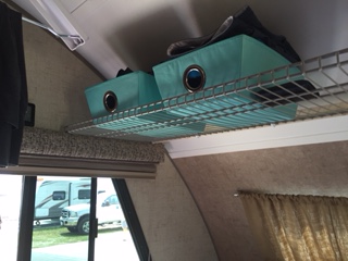

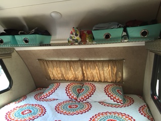

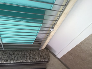

We have made a few "mods" to our 2016-178. I have seen several shelves added above the bed. We wanted ours to be removable and found that the window valance is very sturdy. We reinforced the back of a section of wire closet shelving with a 1x2 board and attached it with the standard shelving mounting brackets. We put the rubber caps on the ends to keep from damaging the walls. We take it down as part of our tear-down at the end of a trip. Pictures below:
My pillows are against the wall, of course the bed doesn't face that way
this picture is looking from underneath

Looks nice, adds a lot of storage

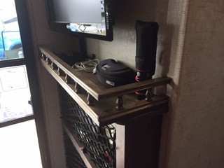

Another "mod" we have made to our 178 is to the small shelf under the TV. We added a board with a galley railing... just gives a little more storage room. We will be adding another shelf, similar to this one, above the microwave.

I like "all of it" thanks for sharing

Great mod, we are planning on doing something like this. I have one question, is the 1x2 attached to the wall or shell or is it just resting on top of the valance?
Thank you for any info

Thanks! The 1x2 is attached to the shelf and resting on the valance. We felt like the valance was stronger than anything we could have done. We do have to take it down every time but I'm sure you could attach it to the valance.

Thanks for the pics of your shelf! Hope to do that this weekend to our 2014 178. What length shelf did you use? The width from wall to wall is about 74". Did you use an 8 ft. shelf and cut in down?
What a great idea!!

I used the six-foot shelf, but made wooden brackets which sit on the valences with metal angle braces that hook behind the valence and command strips which keep it stable. The shelf (Allen & Roth from Lowe's) sits on the wooden brackets. You can see pictures in my mods.

We used a 6ft shelf. It lays in there perfectly. Just put the rubber caps on the ends to protect the walls.
