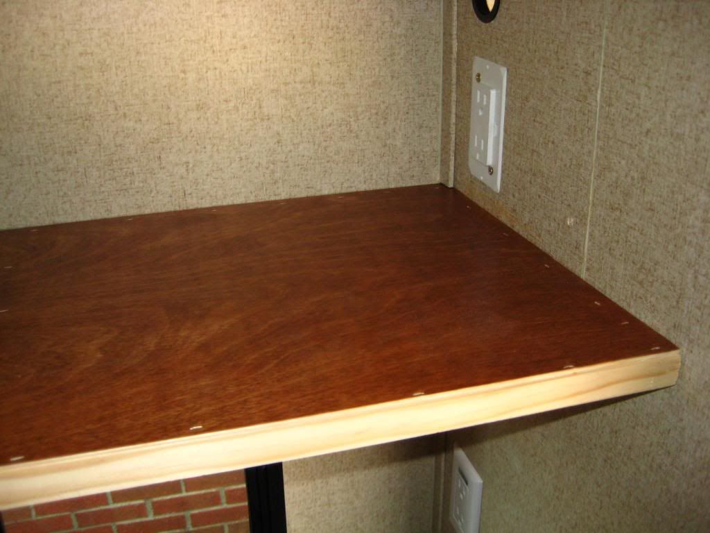

Post Options Post Options   Quote TanksMom Quote  Post ReplyReply Direct Link To This Post Posted: 04 Apr 2014 at 12:16pm
Cabinet bottom screwed into wall.

Post Options Post Options   Quote TanksMom Quote  Post ReplyReply Direct Link To This Post Posted: 04 Apr 2014 at 12:15pm
English Chestnut wood stain used. (tried the pecan but not dark enough)

Post Options Post Options   Quote TanksMom Quote  Post ReplyReply Direct Link To This Post Posted: 04 Apr 2014 at 12:13pm
New frame made with wider middle braces and Kreg System and screws used instead of stables to make the cabinet stronger.  Note Titebond wood glue use also.
