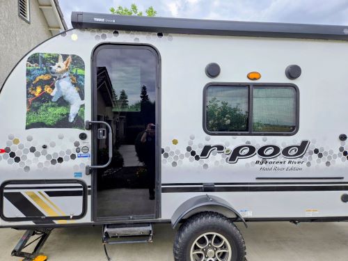

Hockey puck support brackets for Thule awning.
