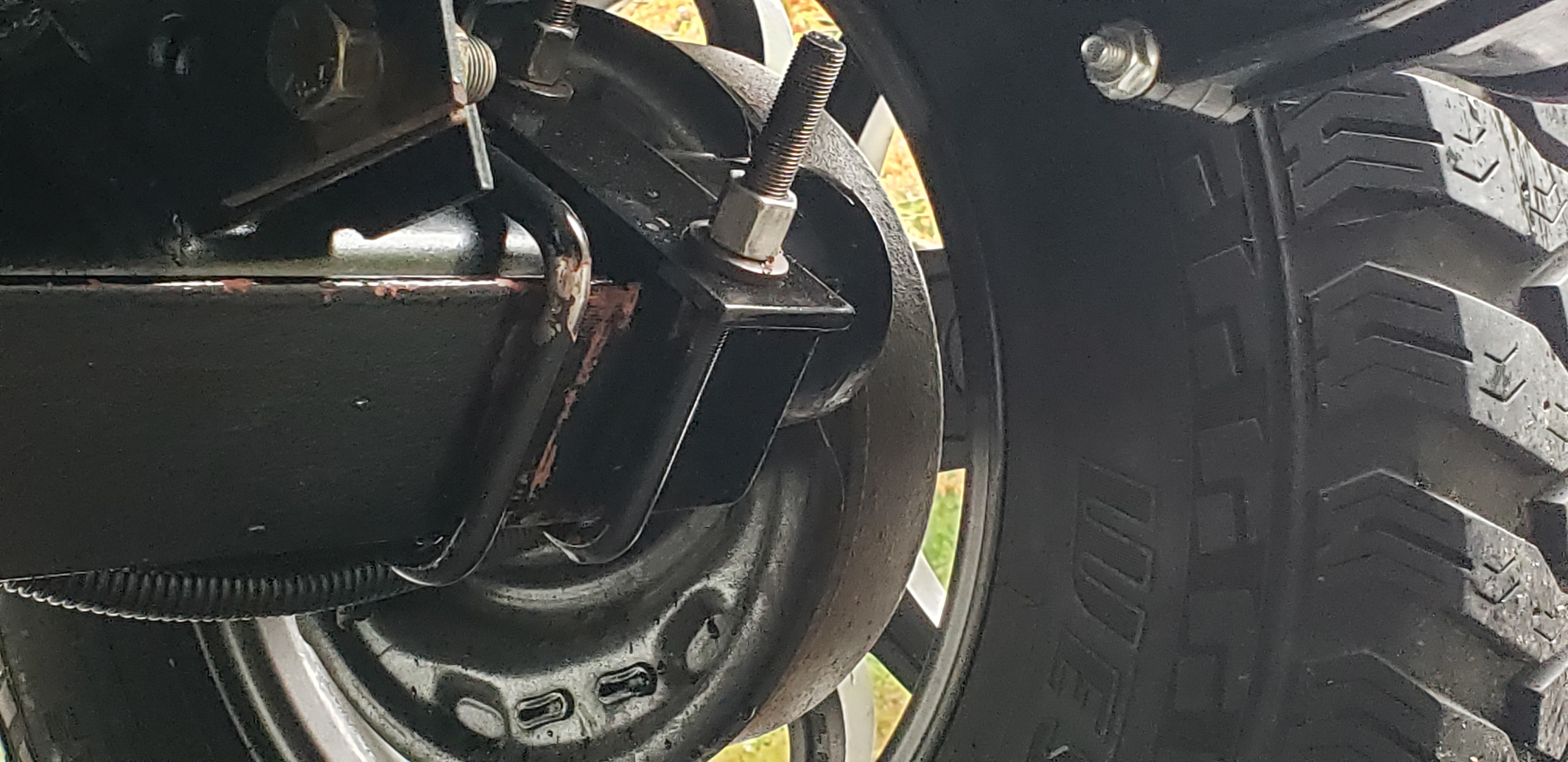

R POD – Despite the following report it did as well as it could under the conditions.  First of all I was glad I did the Offgrid axle support.  After the first incident of lost camber, a new axle, and adding the support, I have really watched the cargo weight and only ran with a 1/3 full freshwater tank and minimal supplies.  Despite the potholes and major slams encountered, the axle camber held great and the wheels are vertical.  But…

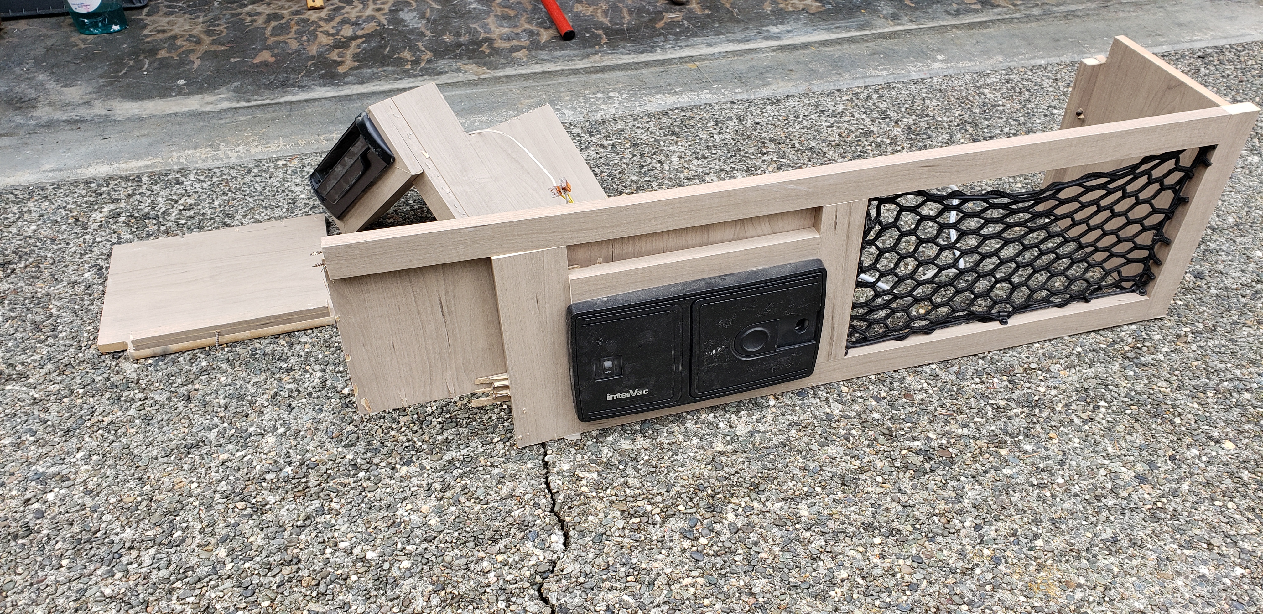

EVERYTHING else rattled and fell apart including:
  • the floor is sagging under the slide…I will have to do the extension brackets
  • sink P-traps unscrewed themselves
  • the whole lower vacuum cabinet module separated from the upper cabinet

Here is your axle support in action after over 5600 miles...
Before and after:
Held up great besides my paint job getting sandblasted.  Miles of gravel blasted off my zip ties holding the brake wiring too.

Post Options Post Options   Quote offgrid Quote  Post ReplyReply Direct Link To This Post Posted: 22 Jun 2022 at 11:42am
Mine got surface rust too, used to live near the beach on the OBX. Not an issue. If you want you can spray everything under there with Fluid Film. Seems to be good stuff, lanolin based so it won't hurt your clothing.

It is well documented here on the forum.
The axle is only rated for 3500 lbs with dry weight of 3200 lbs leaving about a 300 lbs cargo capacity.  Not much when you consider water hose, electrical cords, wheel chocks, food, pots and pans, clothing...it adds up fast.
Top that with the unit's frame supports being too far inboard from the ends causing a cantilever, the camber can be lost from overloading and hitting a big bump.  It is very evident when your wheels toe in at the top.
Good camber:  About 1/4" gap with a straight edge.
Bad camber:  No gap with the straight edge.
Wheel tipped in at the top:
Offgrid's fix is a 3x3 structural angle supported by opposing U bolts to help stiffen up the cantilevered axle location.
