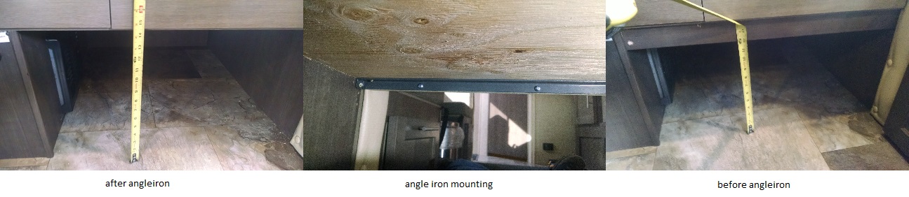

Angle iron to open up the underbed entrance 2.5 ", and let the heat out better.

3. I Put a piece of 3/4 angle iron replacing the upper face frame under the bed. this will support the center drawer guide supports and let heat out better and open up the opening a little.
4. Here a picture of the drawer face frame. I used a 48" x 11" shelf piece and ripped it down to 9 1/4" and cut drawer holes into it. It does not go behind the seatback, and I had to add 4" to the refrigerator  end because the shelf wasn't long enough to span the distance.
5. The angle iron screws down to the plywood to the drawer guide supports and then to the face frame. The face frame screws into the drawer box at the ends and in between the drawers.

Thank you for the details. I will have to see if I can use a couple of the steps: angle iron and move the water pump.
Posted By: voisj
Date Posted: 17 Nov 2016 at 10:19pm
Stephan, on the angle iron, if you just unscrew the 2 square head screws on each end and rotate it up you get a nice finished edge facing the cabin and the angle iron just hides behind it. And what kind of ladder fits in a 5x5 space?

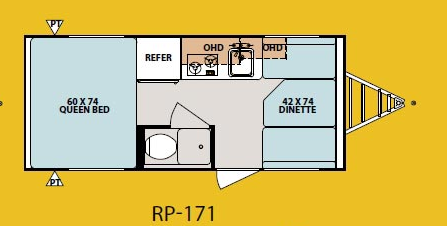

Nice job, I would like to add drawer space, but I have 171, limited to any kind of re-vamping.

Look for space that may be hiding from you. I do not have a 171, but I am sure that you could do some creative work to add space. Perhaps you could do something like a shelf similar to the one I put above the bed in our 179. From the floor plan, you do have a queen bed. That would be a start. I don't know for sure, but you might be able to do something with space under the bed also if the heater is not located there in the 171.

Looks like the 171 has a queen bed. This mod could work the same way, you could do 1 large drawer that would come out between the fridge and the bathroom, over the storage door.

Unfortunately due to the curvature this mod won't work on the models with the rear bed.  The front has a long flatter "vertical" spot where you can lift the mattress upward, but the rear curve continues all the way to the bottom so there won't be room for the mattress if you move upward 5-6".  See my signature pic - the mattress on front or rear models starts about where the orange and red marker lights are on the side.  Love the idea though!

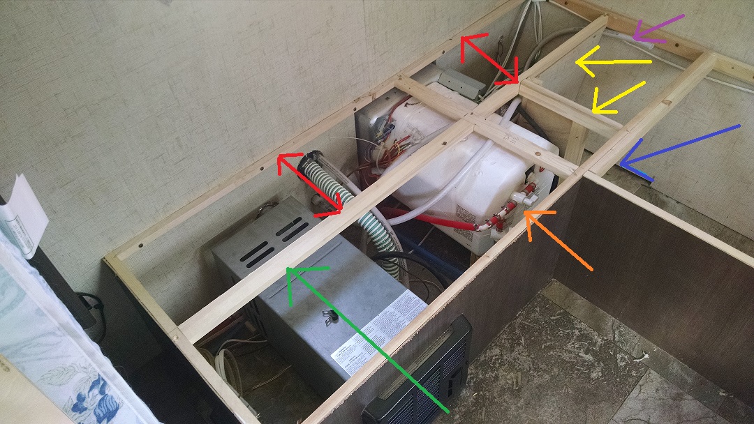

Posted By: voisj
Date Posted: 02 Dec 2016 at 8:48pm
Bill-j,
So looking forward to seeing your mod!
 Hope this helps;
1. The green arrow is where I would stop the lower plywood. This added 1x2  is where the drawer box sits. I ran the plywood all the way to the wall and then went back and cut it out for better access when the top plywood is off. You could skinny up the drawers to make this opening larger for better access A few Inches would make it easier to get to the valves from the top after taking off the top plywood.
2. The red arrow is the area I cut the lower plywood out for access. I do not use this as storage because I could not figure out any reasonable way to access it.
3. The yellow arrows point to the panels that i can unscrew and gain access to the pump and the back of the water heater valves if i need to through the storage compartment. It's tight, but i can fit back there with a little magic.
4. The blue arrow is an area i left open that I can reach in and turn valves on the back of the water heater (orange arrow), after climbing in the storage door.
5. Purple arrow... I have no idea what this pipe is used for, Please let me know!
I maybe would have made the drawers not as deep, (i went 4' for max space) so the front storage could be taller and when the top plywood is off there is even better access from the top for the pump and valves.
Also once the top plywood  is off the drawer box just unscrews and lifts out and I can remove the lower plywood for full access.
Living on the coast in central California means It never freezes here, I wasn't even thinking about winterizing, Good call!
Rgds Joihn
http://www.rpod-owners.com/forum_posts.asp?TID=9426&title=slopod-180-mods-johnsue - SLOPODMODS
John&Sue,SLO,CA

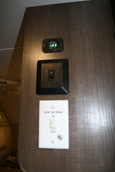

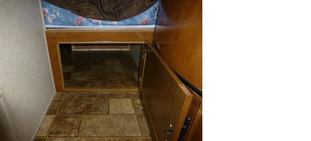

Posted By: Bill-J
Date Posted: 02 Dec 2016 at 9:56pm
Thanks for the reply John.  In the posted picture I do not find the blue nor purple arrows.
One thing I did was to cut the paneling in front of the water heater.  I mounted hinges on the right side of the panel I cut and thumb latches to hold it closed.  With this I have lie on the floor but I can open the hatch and work the valves on the water heater... Can't figure out how to get to the water pump, however.
We are leaving for Plam Springs next week so your mod and others that I can figure out will have to wait until we get home.
One question please.  Does your battery charger (which on my unit is breaker #7) create noise on the AM radio?  With the charger on the AM radio us useless and the CD is very distorted.  Turn the charger off and all is well.  Any thoughts?  [I also get some noise on breaker #3 but not as bad]

Posted By: Bill-J
Date Posted: 02 Dec 2016 at 10:05pm
Follow on... I printed the picture out and now I can see the other arrows.
I think the hose marked with the purple arrow is the suction to the water pump for sucking in the RV antifreeze (if you want to go that way).
Where you left the opening so you can go in through the outside door and crawl in I do not need because ot the door I cut in on the panel below your orange arrow.  Door is about 12" X 12" so plenty of room.
When in doubt, don't.
Posted By: voisj
Date Posted: 02 Dec 2016 at 10:16pm
Bill, I like the door idea to the water heater send a picture of it! To get to the water pump you have to remove the mattress and plywood for good access. You could crawl in the storage area and just unscrew the small divider though. I also get some interference on the am radio but hadn't found the source till you mentioned the charger.should only be a problem when plugged in to shore power.

Posted By: Bill-J
Date Posted: 02 Dec 2016 at 11:01pm
John,  How long does your battery last from a full charge?  I fully charged my battery then disconnected the AC.  The battery was 100% according to the LED indicator.  With EVERYTHING off in 24 hours the battery was showing full discharge on the LED indicator.
When I bring the unit to the house for loading it up I'll take a picture of the door and send it to  you.

Angle iron mod pics This one opens up the under bed storage and supports the drawer sides.
