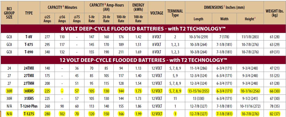

The answer is capacity, cost, and effectiveness. A single 12V GP24 battery like supplied with your camper has a capacity of 85AH. Two 6V GC2 batteries provide 220AH. It would take three GP24s or two GP27/30s in parallel to approximate this capacity. Due to the huge number of golf carts in the world the GC2s can be less costly.  And due to physics, battery cells work better in series instead of parallel. The cells in two GC2s are all in series. Paralleling multiple 12V batteries puts the cell groups in parallel which is not as good. See the following excerpt from the Trojan battery catalog:

Also, with GC2's, you get TRUE deep cycle batteries, which are less likely to be damaged when deeply discharged.. (below 50% capacity)
