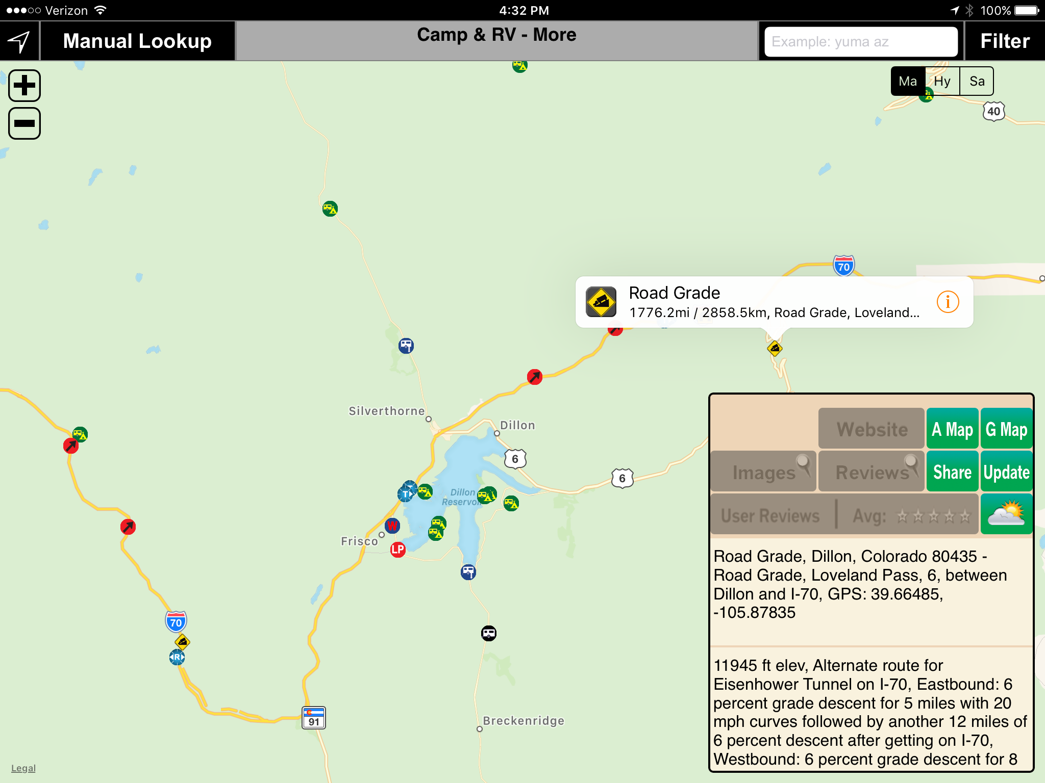

Posted By: ronahue
Date Posted: 24 Sep 2016 at 4:43pm
While it will not show a route Allstays app will provide excellent information on grades.
