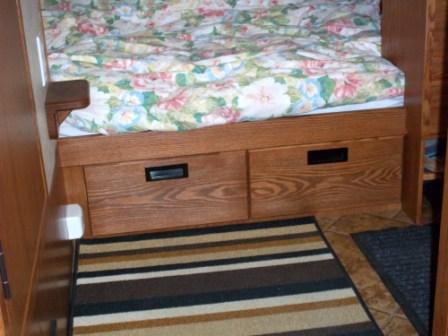

Posted By: Marco T
Date Posted: 07 Aug 2016 at 6:17pm
Another user also made a pull-out drawer that you can access from the inside.  I think this is a great idea. That way you split the compartment in two, but we found that if we keep items we don't use that often in the harder to reach side it's not a big deal.  I'm going to try to put a drawer in ours this month.  I started taking some measurements this morning (about 34"x13.5" will be the size of the drawer face) and the first thing I want to find is a roller system for the drawer so the kids can handle such a big drawer.
