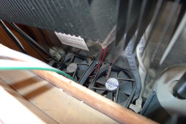

I posted a picture of the fans in another post. You will need a mirror to see the fans, and if you follow the red wire taped to the back side of the refrigerator it will end at the switch. You need to remove the upper vent cover to see the switch.

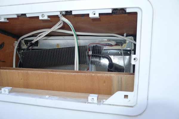

from the outside top opening
Posted By: osage
Date Posted: 20 Jun 2016 at 12:51pm
outside top opening

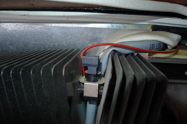

Date Posted: 20 Jun 2016 at 1:31pm
Here are some pictures of the switch and fan on my trailer. The switch clips on to the condenser tube and it is set to open at 70C (158F) and close at ?. All are accessed thru the upper vent cover on the outside of the trailer

I have the same problem Jon.  Have had our 177 since March 2011 and have never heard those muffin fans come on.  Just did a test 15 minutes ago to see if they actually work.  Took off the 2 spade connectors (they have red wires attached) and ran a jumper to connect them together.  Found out they actually work, should have seen the dust blow off those fans!  Anyway, I figured the thermal switch must be kapoot so took that off and tested that by holding a lighter under it.  In about 3 seconds I heard a click so I immediately took my volt meter and tested for continuity, which I had.  About 25 seconds later it clicked off so it must work, just odd that with the 'warm' weather we have had that it doesn't activate.  May have to find another location where the temp will be warmer.
Posted By: JandL
Date Posted: 13 Aug 2016 at 6:40pm
On my original post and pictures on page 2, I though the F70-10C marking on the thermo switch meant 70 degree Fahrenheit. I have found out it is 70 centigrade so that makes it 158F. Some other people on the internet have said the Dometic Refrigerator Thermodisc with Fan Clip #2412906204 is rated to turn on at 150F. Right now at my house it's 100F and I turned on the refrigerator and you can hear the fan turn on intermittently.
