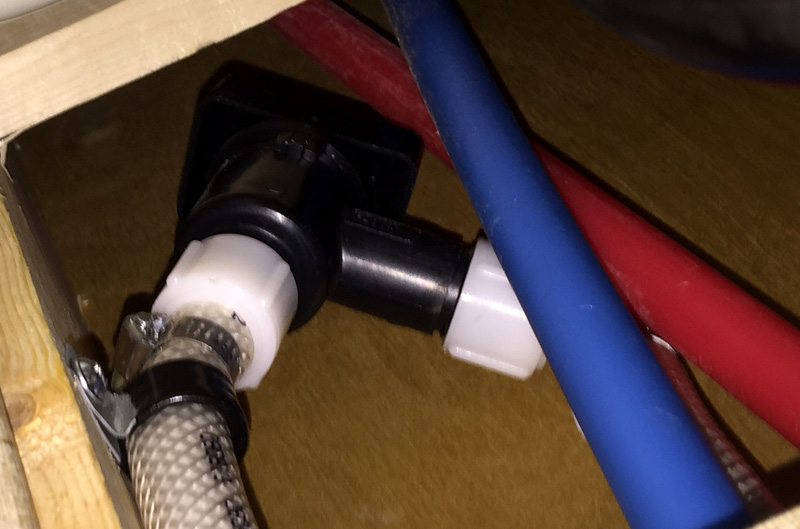

Posted By: funks
Date Posted: 27 Mar 2016 at 5:28pm
Happy Tripping
Attach is a photo of the one-way valve. The picture is shot up from the floor of the shower. The valve is black. The square part of the value needs to be at the top or close to the top.

Posted By: SandD
Date Posted: 18 Apr 2016 at 2:29pm
Is this the picture of the valve position corrected?
Mine is installed as pictured
