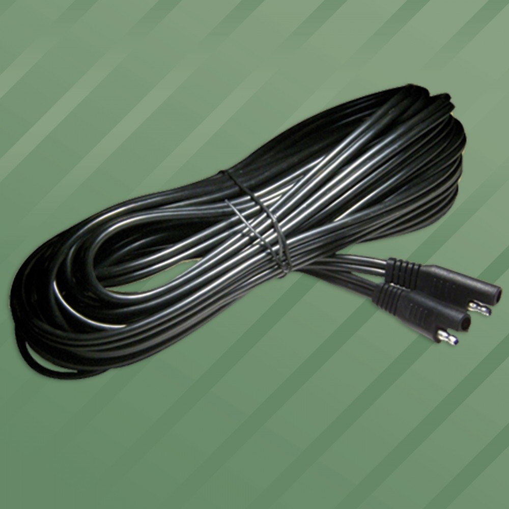

The Zamp Solar system is mfg here in Bend Oregon.  The extension cable I purchased looks quite similar to one sold by Battery Tender.  Overall, although pricy, the Zamp system is functionally easy to setup, monitor, and stores nicely beneath the rPOD 179 sleeping platform, where I also store a step ladder to aid in attaching the Pahaque Custom awning and slide cover.

The extension cable in the picture from Battery Tender looks remarkably similar to the Zamp extension cable I purchased for 4x the listed $$.  I need to check the wire gauge, but suspect this Battery Tender extension cable should work on my Zamp 120 volt panel setup.
