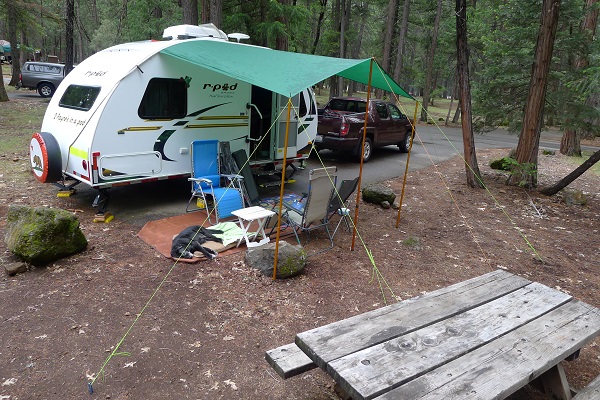

Well I followed your example--- just upgraded the tarp to a Kelty Noah 12 x12 --- sewed in the 1/2 inch poly rope using the zipper foot.
i used 2 8 foot folding kelty poles and made some guy lines from Para-cord (in Florida you can not tie to trees)
end result is nice-- and a breeze to set up.

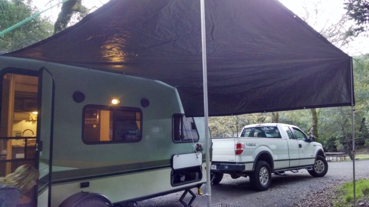

Posted By: voisj
Date Posted: 30 Nov 2016 at 9:15pm
JandL,
Followed your lead on the tarp awing, Used sail slugs for the channel and just tie wrapped them to the tarp. I use a bungee cord at each end just pull it back or forward  to get shade or rain protection.
http://www.rpod-owners.com/forum_posts.asp?TID=9426&title=slopod-180-mods-johnsue - SLOPODMODS
John&Sue,SLO,CA
Posted By: craigwood
Date Posted: 01 Dec 2016 at 12:10pm
I'm not sure what sail slugs are and a close up picture of the tarp/channel would be appreciated.  This system looks simple and inexpensive - my kind of diy project!  Thanks
Posted By: WJR3
Date Posted: 01 Dec 2016 at 12:42pm
Can you let us know what size slugs and shackles you used? Seems like an nice easy set-up!
Posted By: voisj
Date Posted: 01 Dec 2016 at 12:58pm
Craig wood & WJR3,
Sail slugs go on the leading edge of a sail boat sail and feed into the mast when you raise the sail. Here's some pictures of the awning and slugs. The shackles are just a carabiner  type also used in sailing, with a small end and a large end that opens.
Sail slugs, .56 cents each.  I used the 3/8 slugs (cut them off an old sail)
I use a bungge cord at each end to keep it tight and also adjust the overhang to be forward or aft.
I bought 7' adjustable tent poles at my local camp store. I use the pole to push the sliders down the track, 8' pole  or 9' pole would be better because you could adjust them for grade changes , they sell them at Cabellas on line $14.99
There is a small gap at the trailer rail, I rained 2" the next day (Eureka CA) and it wasn't a problem.
John&Sue,SLO,CA
