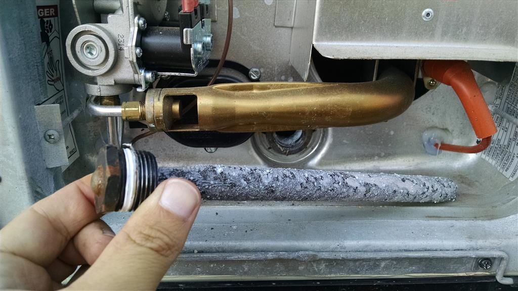

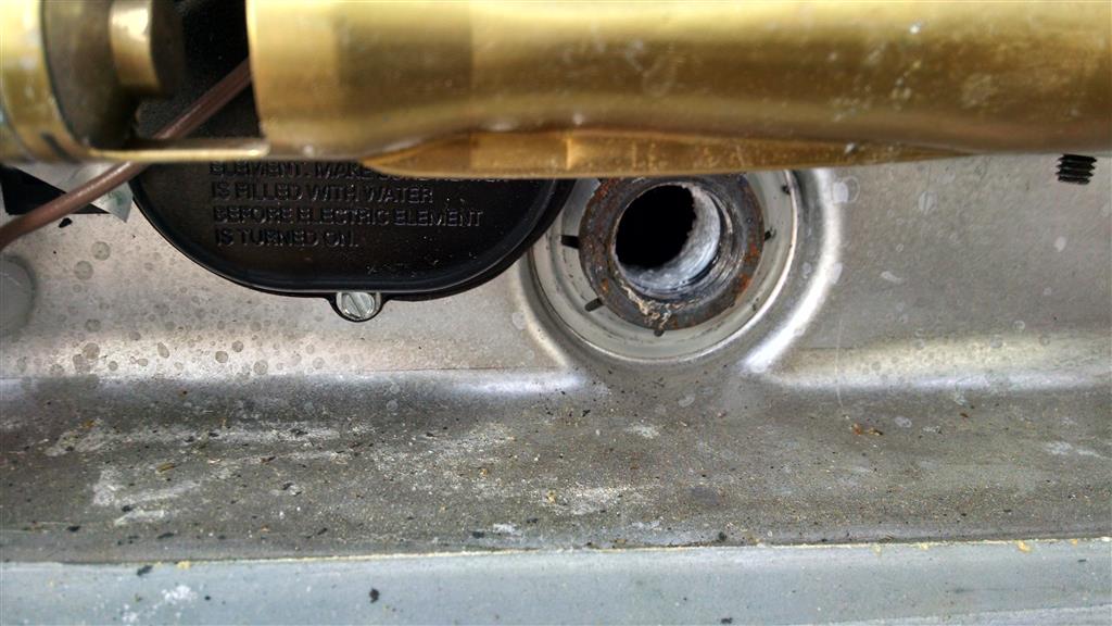

As per prior post, on my 2015 RP-179, I drained both sets of low point drains with faucets open.  After waiting till emtpy, I then unscrewed the anode to see if any water came out.  Result?  Only a few drips came out.  See dry horizontal surface of water heater compartment below; no water.  So, the low drain point caps does drain the hot water tank.  Thanks all for your input; glad this one is solved.
Also, check out my anode.  Should I replace it?  This is after 3 uses....
2015 R-Pod 179
Posted By: techntrek
Date Posted: 10 Aug 2015 at 10:53am
That rod is fine and should last a year or three.  I finally replaced mine after 4 years and didn't really need to, it looked about like yours.
Posted By: SNO4ME
Date Posted: 10 Aug 2015 at 2:22pm
Mine was roughly the same and I changed it last fall at winterization time on our 11.
Mostly because the previous owner had left me one so I used it.  If I would have had to go buy it I probably would have gone another year or two.
