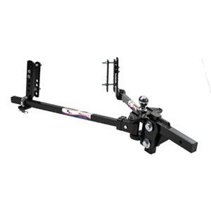

Thanks! I know that we'll need at least a sway bar but I was thinking on a WDH also. Would one such as this also help with sway?
Posted By: SiberD
Date Posted: 31 Oct 2014 at 4:01pm
Nevermind, I found out that is an E2 that a bunch of ya'll use and are happy with.
