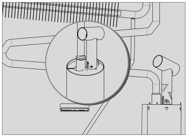

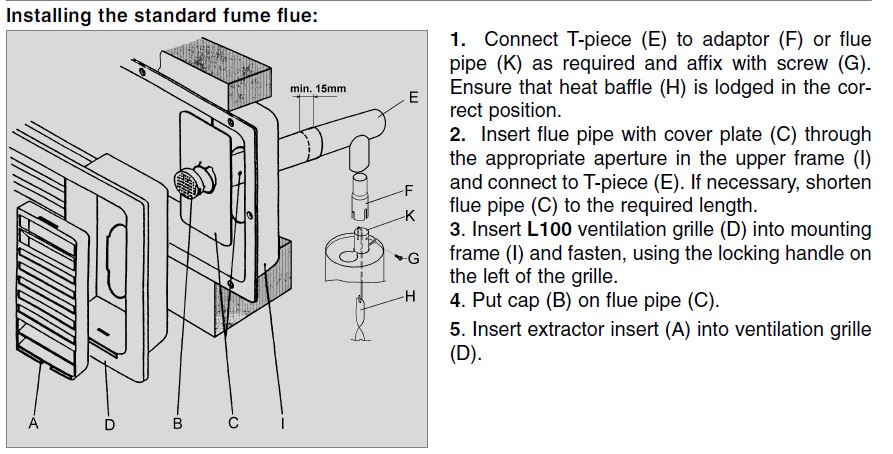

I found something very interesting in the European version installation manual of the 8501 today-
You know the little odd shaped chimney the gas exhaust vents out of, inside the compartment, on ours?
Well, on the European version there is an extension that takes it completely out of the compartment through the upper vent assembly.   The upper and lower vent assemblies look nothing like the ones used here.
Hmmmm....makes me wonder if venting the very hot flue gas directly out would improve the efficiency of the fridge.
 From the Dometic Installation Manuals
What we have-
What they use in Europe-
2014 179
