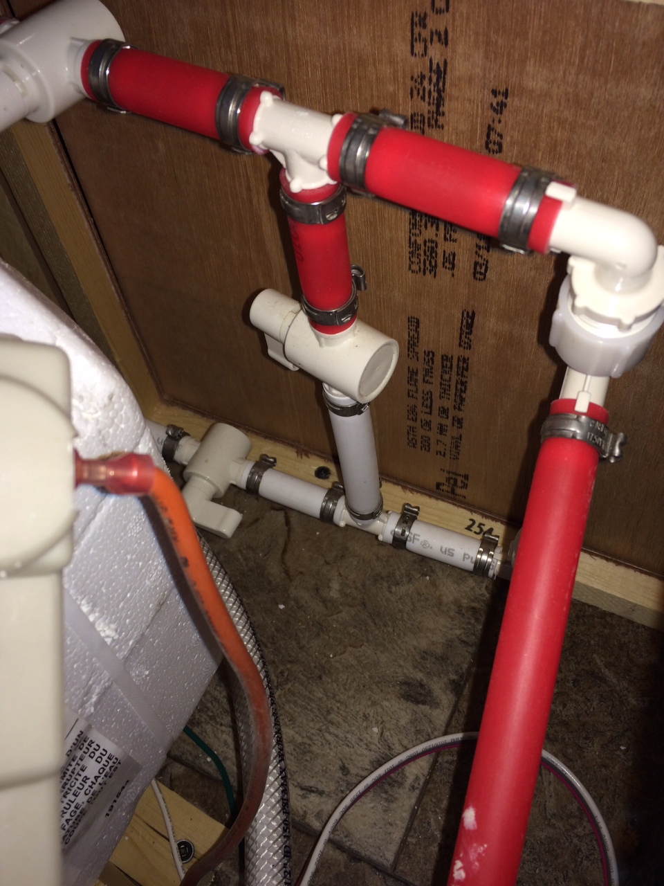

I found the bypass valve and that was the heater problem. I also found that i have what i think is the valve for winterizing from the water pump.  Had the wrong manual for the stereo.  This stereo model does not have blue tooth but does have HDMI and compatible with all iPhones (but iPhone cable in the back and is a 12 pin connect i think-i never seen that type).  The face will connect via headphone jack, so that will work i think.  attached are pics of my 182 g heater, water heater and water pump under the seat in the kitchen seating. I don't like the access and will be redoing that.  (forest rive can do better there for sure)

Hopefully that picture is the "before" shot before you fixed your problem.  The bypass valve (the one in the middle) should be closed during the summer but is open in the pic.

Date Posted: 29 Jul 2014 at 4:49pm
yep, that was the "before"
Closed it up and hot water good to go.
