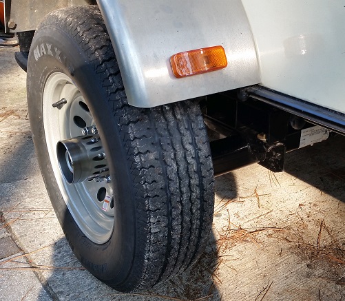

I mentioned in another thread about some axle issues with my new 179.
After 1000 miles or less I noticed the wheels started to lean it at the top- negative camber.
I also noticed the upward bend in the middle of the axle, put there during manufacture to give positive camber unloaded, with ideally close to zero camber when loaded, is now gone from the axle.  IOW it has bent.
So-  curious I headed off to the CAT truck scale.
The axle of the trailer has 3320 lbs on it ready to travel with a full tank of water, the stuff we usually carry and zero food or clothing, nothing in the black or grey tanks.
Note this is without the weight distributing hitch hooked up which would easily add 100 lbs to the trailer axle, and probably more.    I'm guessing with another 100 lbs between the fridge items other food and clothes we would be around 3520.  The axle is rated for 3500.
Just for reference the tow vehicle, a Toyota FJ Cruiser weighed in at 5360 lbs with 3/4 tank of gas and no driver or passengers.  Note a good 400 of this is tongue weight from the trailer.
Now I see why the axle is bending after only a 1000 miles of road pounding....
Question for other 179 owners-  are you seeing this?
Oh and spare me the lecture about not traveling with a full tank of water-  we are heading out soon on a long trip where we will spend up to 6 days at a time in remote campgrounds out west without any water source so the tank will be full at times..

Don't know why my 179 is having issues-  but since I leave soon on an extended trip and don't have time to have a dealer look at it etc..
I just got back from visiting the local Dexter distributor and have a 5000 lb rated axle on the way and 2ea 15x6 rims to mount my tires I already have.
His Dexter contact promised the axles will ship on 7/28 and will be here by 7/31!   So that gives me enough time to do all the work and hit the road as scheduled-  I'll deal with whoever, Dexter or FR, when I get back.
I also spec'd the axle to have a 10deg down arm instead of 0, that will raise the trailer a couple of inches, which I wanted to do anyway, and give enough clearance for the larger tires in the fenders.
The 15" tires will have a total rating of 5,080 lbs instead of just 3,520.  The trailer will never be loaded anywhere near that of course but I like overkill when it comes to tiresSmile

I believe my tires have always leaned in at the top.  15,000+ miles so far and the only oddity is the 2nd ring of tread from the inside, on both sides, is worn down more noticeably than the rest of the tire.
Posted By: lippy1979
Date Posted: 30 Jul 2014 at 9:42pm
Its typical for torsion axels to behave in such a way.  The wheels will canter out when unloaded and as you increase the load, they will canter farther in.  I personally would never travel with a full tank of fresh water.  Fill up at the campground or just buy 3 gallon containers.  Water weighs A LOT and puts undue strain on the axel.  Not to mention making it harder to control going down the road.
Posted By: Budward
Date Posted: 31 Jul 2014 at 7:29am
Originally posted by lippy1979
Its typical for torsion axels to behave in such a way.  The wheels will canter out when unloaded and as you increase the load, they will canter farther in.  I personally would never travel with a full tank of fresh water.  Fill up at the campground or just buy 3 gallon containers.  Water weighs A LOT and puts undue strain on the axel.  Not to mention making it harder to control going down the road. .
Yes the wheels have positive camber when unloaded.  When loaded they should ideally have zero camber. If they have negative camber at rest the axle is bent or overloaded.
The axles are made with an upward bow in the axle tube to create the positive camber.  My axle on the rpod has no such bow now, it had it when new.
I own multiple trailers with torsion axles and NONE of them except the rpod have negative camber.

It may not have had the upward bend when purchased but it did when it left the axle factory!
I confirmed with Dexter that MY axle, which they looked up the specs by the serial number, was built with positive camber via the upward bend.
As I said I have other trailers with Dexter Torflex axles and they do not have the negative camber issue.  Of course neither trailer has ever been run with anywhere near axle capacity, both are 7,000 lbs rated with two 3,500 lb axles.  Heaviest has probably been in the range of 5-6000 lbs loaded max..
Anyway- my replacement 5000 lb rated axle is due to arrive at the distributor today...I hope it is on time as a forecast 2 days of rain is on the way.  Need to get this swapped ASAP as we head out soon on a multi week 10,000 mi+ trip!

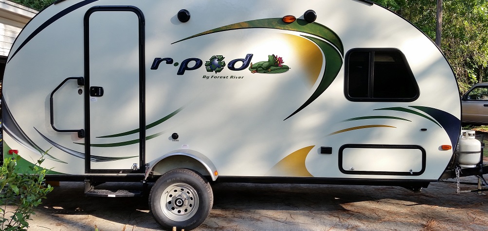

pics!
Posted By: Budward
Date Posted: 06 Aug 2014 at 11:17am
2014 179
Posted By: techntrek
Date Posted: 06 Aug 2014 at 12:21pm
Definitely some serious lift.
Posted By: Budward
Date Posted: 06 Aug 2014 at 12:50pm
Yep!  Looks really good behind the FJC which being very off road capable is higher than most SUVs.
2014 179
Posted By: wildfire305
Date Posted: 06 Aug 2014 at 1:26pm
Maybe add mud flaps or lower the fenders? The angle of spray from that tire is gonna cover the side.
