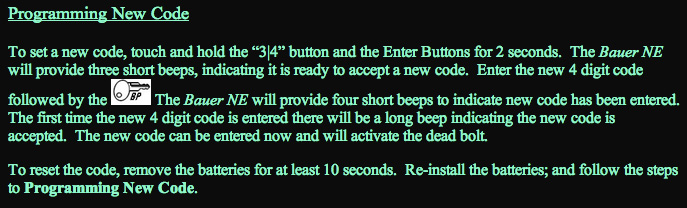

I bought my 178 last October and have had no problems with the lock and quite like it. I did replace the batteries once so far and lubricate it with Blaster (PTFE). As the pod is in my driveway I am going in and out quite a bit and do lock it at night.
Also, I keep this very handy...just in case I need to reprogram:
