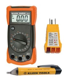

Date Posted: 26 May 2014 at 1:46am
When we bought our Rpod 177 it came with a power cord. I had a new 50 foot 30 AMP boat power cord with twist locks plugs on both ends of the cord. I decided to use the the boat cord and made a cheater adapter to go from the twist plug to a regular 15 AMP plug. I found this plug at Home Depot...
http://www.homedepot.com/p/Pass-Seymour-15-Amp-125-Volt-Straight-Blade-GCM-Plug-PS5266XGCMCCV4/202039721?cm_mmc=shopping-_-googleads-_-pla-_-202039721&skwcid&kwd=&ci_sku=202039721&ci_kw=&ci_gpa=pla&ci_src=17588969
The plug has LED lights that tell you in code if the receptacle your plugging in to is wired correctly. Green LED everything is OK. Red LED or any combination signals a incorrectly wired receptacle.
I thought it was pretty neat. I may start using them on construction sites

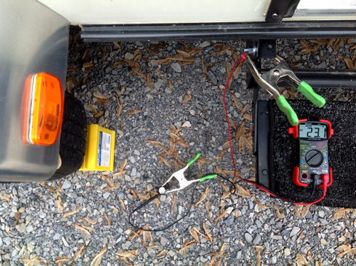

You guys may have saved a life here! No Kidding!!
My Pod is in the driveway. It's just a hair too far to comfortably plug into garage outlet. I have been using one of my molded Home Depot Yellow Jacket 12/3 25 ft. extension cords for the last few feet inside the garage. It's also the extension cord I take camping. The factory Pod shore power cord goes under the garage door at home.
Soooo, I just got my Fluke VoltAlert from Amazon. Without reading any instructions I pressed the green on button, walked outside and touched the tongue jack. Holy s#%t!! It beeped loud enough to scare the cat! Really! Kinda freaked me out. I touched various other parts of the tongue. Same thing. I tested the steps. Same thing!
I figured it (the tester) must be broken. Time to get out the voltmeter.  I've been using these extension cords for years. I got a 25 footer, 50 footer and 100 footer I use around the property. Never had a problem. I rarely go barefoot.
With voltmeter, positive probe to tongue jack bolt, negative just stuck in gravel driveway. Holy s&$t again! 39.7 volts. I unplugged the pod!
OK, first thing I checked was garage plug polarity. It is fine. Next, checked continuity in extension cord. It checked fine. Next, I was just able to plug pod shore power cord in garage outlet. No voltage seen at trailer frame. I unplugged and replugged several times just to double check. Next, I put extension cord back in place. Hmmmm. No hot-skin.
Sooo, I started playing with the pod shore power cord/extension cord interface. I could actually hear a faint "crackle". Obviously, a good connection is not being made between adapter and extension cord. I would guess it's the ground connection. I have had those break off before.
Until I am comfortable that I have solved the problem, I will not use the extension cord and will keep my VoltAlert very close by!!
Thanks again!!

Wow, already!  I expected to eventually hear back that somebody tested positive, but not in the first 1-2 weeks.  Glad to hear the tester caught that.

There's nothing wrong with your Twist-lock connector. It's beeping everywhere because of the large contact areas inside the plug. These capacitive testers are calibrated to find 120-volts on a small surface are such as an extension cord or 15-amp Edison outlet. Of course something as large as an RV hot-skin will cause them to light up at as little as 40-volts and a foot or two away. Sure gets your attention, doesn't it?
That ability to beep at as low as 40-volt and from a foot away with a 120-volt hot-skin is what I discovered in my initial tests. None of the NCVT manufacturers were aware that their testers would work like that and would be useful for finding RV hot-skin voltage. I have dozens of emails from RV owners around the world who say that I probably saved a life. Please contact your RV dealer and manufacturer about supporting more No-Shock-Zone articles and clinics. R-pod and Forest River should know about this test procedure.

When checking the voltage of a possible hot skin, what's the proper way to test if you don't have a good earth ground near by or your multimeter cords aren't long enough?

A NCVT such as a Fluke VoltAlert gets its ground reference by coupling through your feet to the ground, which is why you need to grip the tester in your hand. For a voltmeter test, a screwdriver in the ground will suffice for earth reference. If you're in dry soil, dump a gallon of water on the dirt first to improve conductivity. Please note that this is NOT a true ground rod and won't protect you from a hot-skin current leakage. It's a high-impedance earth reference at best, but should give you an accurate earth potential measurement using a modern digital voltmeter. Don't use a solenoid tester for this measurement as it has too low of an impedance for this type of quickie earth ground.

I have a no touch cheap tester that seems to work well for testing the power outlets. I thought i had a hot skin condition this past weekend on our trip. The 30 amp outlet at the power post had proper polarity however I was getting a positive test with my no touch tester around the steps,door frame, and frame behind the steps. I had to touch the tip of the tester to the surfaces for it go off though.(My power distribution panel for the rv is directly next to the door just inside within 8 inches.). I switched over to the 20 amp outlet on the post and at first my tester was positive at the steps but neg on the door frame. I double checked the polarity of the 20 amp outlet and it was correct. Afterwards I could not get a positive signal again at the steps or anywhere else.  (I know my tester was working bc I check the breakers in my distribution panel and it worked). I never switched back to the 30 amp outlet and tested the camper again hooked to 30 amps.
At home in the driveway I have a 30 amp outlet and I do not get a positive result.   I have not checked with my multimeter yet as I wasn't quit sure how to reach a ground for my meter.
Everyone should be aware that reversed Hot-Neutral polarity by itself WILL NOT cause a hot skin condition of any kind. It will, however, endanger the life of any technician working inside an open electrical panel that's powered up.
Also, it's important that your NCVT is calibrated against some known standard. Some of them have higher sensitivity than others and thus there's no easy way to predict the actual voltage they'll trigger on with various energized surface areas. Even with a common NCVT, there will be a lot of trigger voltage variance depending on how large of a surface area is energized. If you get ANY NCVT beep/flash touching the tester tip to ANY part of your RV, then I would suspect you have at least 40-volts hot-skin. Usually, beeping at 4 inches away from an RV chassis suggests around 60 volts, 8 inches away suggests 80 volts, and 1 to 2 feet away suggests 120-volts. Of course, an RV with a totally metal skin will offer a much larger energized surface than a fiberglass RV. So an Airstream with an aluminum body at 120-volt hot-skin will light up a tester from 2 feet away, but your R-pod with 120-volts might only do it from 1 ft away.
However, the only way to know for sure is to do exactly what you propose... measure between earth ground and the RV chassis with an actual voltmeter. Remember that you'll need to poke through any paint or rust on the RV to get an accurate reading, so I've found that the lug-nuts on the wheels to be a good spot to poke a meter probe that won't damage any cosmetics. No need to try this at multiple spots on your RV. If it tests high at one spot, then it will be everywhere. Measuring any more than 2 or 3 volts from the RV chassis to an earth ground rod reference is suspicious and needs to be looked at much closer.

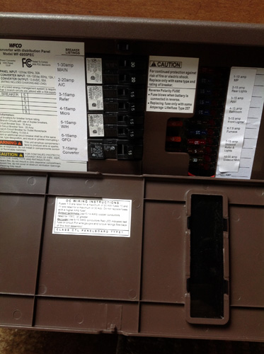

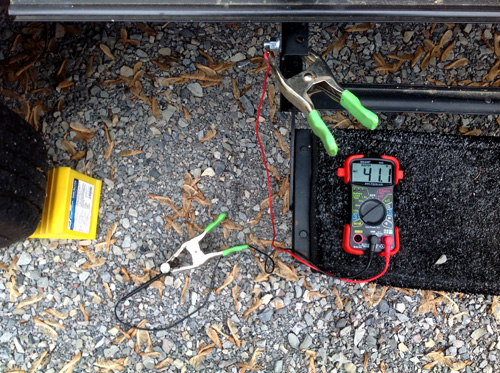

OK, please help me understand what is happening here.
I did a bit of an experiment this morning. Using a landscape nail about a foot deep in driveway I connected multimeter to it and to stair bolt. I then purposely plugged in with an open ground and all breakers on. I then carefully started turning off breakers, top to bottom and recorded voltage.
Closed Ground - all breakers on => 0.132v
Open Ground - all breakers on => 41.1v
Open Ground - #2 AC breaker off => 40.1v
Open Ground - #2 AC and #3 Reefer breakers off => 39.9v
Open Ground - #2 AC, #3 Reefer and #4 Micro breakers off => 28.0v
Open Ground - #2 AC, #3 Reefer, #4 Micro and #5 WH breakers off => 27.3v
Open Ground - #2 AC, #3 Reefer, #4 Micro, #5 WH and #6 GFCI breakers off => 23.1v**
**Only breaker on is Converter.
Only Converter:
Now, I'm more confused than ever. Is my converter leaking a dangerous amount voltage? Is there a threshold of allowed voltage leak? What's going on?
Thanks for helping me try to understand this.

This is normal leakage currents that occur in ALL appliances and gear plugged into 120-volt AC. Here's what's happening. For a piece of electrical gear to be sold in the US it has to pass UL Ratings. UL allows up to 0.75 mA of hot-to-chassis fault current leakage from an "ungrounded" appliance like your iPhone charger, and up to 3.5 mA of hot-to-chassis fault current from a "grounded" appliance like a microwave oven or charger/inverter. Generally there's as much leakage from hot-to-chassis as there is neutral-to-chassis, so you end up with around 60 volts on ANY chassis that's not tied to the ENG (ground wire).
These normal fault currents are additive, so the more circuit breakers you turn on, the more leakage currents will show up on your RV chassis (and skin). So a single appliance (such as a microwave) could be leaking 2 mA to its chassis, but turn on 10 of them and you'll get 20 mA of total leakage current. This is what I call a high-impedance current source since it has the potential of supplying on a small amount of fault current to your body. The reason why the measured voltage is low with only one breaker on and gets higher the more breakers you turn on is that your meter and grounding nail is sinking some of the current to "earth" which forms a voltage divider. So that shows that you have no significant leakage current sources in your RV. If you did, the measured voltage to ground would be 120-volts when you hit the breaker connected to the wire that's shorted to the frame, etc....
So here's the thing. There's a high likelihood that even if you had a disconnected EGC (ground) on this particular RV right now, that there would be insufficient fault current available to cause a lethal shock. But that's just at this very moment. At any time one of your appliances could develop just a little more leakage current to its chassis which ends up on your RV chassis and could kill you or a loved one the next time you touch the ground and RV at the same time. The job of the power cord's safety ground (EGC) is to drain these potentially dangerous currents to the G-N-E bonding point in the service panel and prevent ANY voltage from occurring on the chassis (and skin) of your RV.
Believe it or not, the job of the ground rod (GEC or Grounding Earth Conductor) is not to trip your circuit breaker in the event of a short circuit. The ground rod is primarily there to absorb the energy of near lightning strikes. That's why just poking a ground rod in the earth doesn't actually "ground" your RV. It needs the low impedance EGC ground wire path back to the panel to create a true safety ground.

So, if my VoltAlert alerts me it's time to figure out what's going on and best to unplug until I do!

Fred, what you describe is what I found with my pod last year.  Mine started off with about 60 volts with all breakers on, and that voltage decreased as each breaker turned off.  At the time it drove me nuts trying to figure out what my "fault" was, I expected the voltage to go away when I turned off breaker X, therefore the appliance(s) on breaker X were the problem.  Having it go down with each breaker was very confusing.
At least you only need to track down a disconnected ground somewhere, probably a bent ground pin.

Posted By: techntrek
Date Posted: 09 Jul 2014 at 12:11am
I pulled out my testers tonight while setting up camp (near Great Sand Dunes in CO) and discovered that there is no ground.  Same for a dozen other sites (all empty so it was easy to check).  I made it down to the site next to the next camper a half-dozen sites away and was still getting a missing ground reading, so I asked them if I could check their site.  Happily they were ok, probably on a different panel.  I showed them the outlet tester and VoltAlert and why they are necessary.  They are considering a pod so they may show up here at some point.
Anyway, this is only the 2nd campground with hookups on this trip and already I've found an issue...
Posted By: jmsokol
Date Posted: 09 Jul 2014 at 6:40am
Great work. And that's why I tell everyone to test every hookup every time. You just don't know if something has gone wrong with campsite power either through lack of maintenance or incompetent wiring.
It's important to realize that an open ground on a power outlet is likely what caused the death of the 3-year-old boy in Amboy, IL last week. I've talked to the sheriff that investigated the accident, and their electrician confirmed the open ground. I'm trying to nail down more information and have a call into the electrician himself. Remember, you don't need a secondary fault to electrify the skin of an RV if your EGC/Ground has opened up. There's sufficient normal leakage from your RV's appliances and electrical system to generally bias the skin of your RV to around 60 volts and several mA of current, perhaps even 10 mA or more. That's enough to kill a small child or old adult with a weak heart. And if there's an additional line-to-chassis fault current from something like a pin-hole leak in a hot water heater element or water in a junction box, then your hot-skin voltage source and be a few amperes. That's enough to kill anybody.
And this allows me to introduce yet another concept to you all, something I call a "Reflected Hot Skin". There's a high probability that this particular group of campsites have their EGC Grounds connected together via daisy chaining, but that the final run of the ground wire back to the main service panel has failed for some reason. So now you have perhaps a dozen campsites with their "grounds" connected together, but there's no connection back to the service panel's neutral-ground-earth bonding point. This allows a line-to-chassis fault in one RV to not only hot-skin energize its own chassis, it WILL cause hot-skin voltage on ALL other RV's connected to the same loop. And while a voltage monitoring system  should alert you of the fact that your ground is compromised, it can't disconnect you from a now energized safety ground wire feeding your RV skin with voltage. This explains why some of my readers claim they had no hot-skin voltage when they initially plugged into a campsite, but the next day they were feeling a shock. But, of course, a NCVT will find the now electrified RV skin and chassis. It's cheap insurance that can save your life.
Of course, if you campsite pedestal is properly "grounded" then there's zero possibility of some of RV electrifying your own RV chassis/skin. That's why it's important to test every time before plugging into shore power.
As always, contact me if you've found anything suspicious and I'll help you figure it out.

Will my fluke pen be enough for a good check at my site? Do I need to buy a voltmeter and polarity tester too? I hadn't done that, frankly, because I am most definitely NOT an electrician, and don't know how to use that equipment properly. But if it keeps my family safe, I will learn.
Posted By: Leo B
Date Posted: 09 Jul 2014 at 7:28am
I agree with Bulldogpod. Is there a safe method for non-electricians?
Posted By: jmsokol
Date Posted: 09 Jul 2014 at 8:05am
Ideally, you'll have a digital voltmeter, a 3-light outlet tester, and a Non Contact Voltage Tester. You can buy the full set of Klein meters at Home Depot for $35. http://www.homedepot.com/b/Electrical-Electrical-Tools-Accessories-Electrical-Test-Meters/Klein-Tools/N-5yc1vZboffZ3xg - http://www.homedepot.com/b/Electrical-Electrical-Tools-Accessories-Electrical-Test-Meters/Klein-Tools/N-5yc1vZboffZ3xg
While I use lot of Fluke gear on my test bench (I'm a EE), I find that the Klein gear is a good second choice for consumers and available at any Home Depot.
However, while you don't need to be an electrician to test safely, you DO need to understand electricity. I recommend that everyone with an RV purchase a copy of my eBook No~Shock~Zone RV Electrical Safety. It's the best $10 you'll spend this year. http://www.amazon.com/dp/B00L2DWBD8 - http://www.amazon.com/dp/B00L2DWBD8 So please pass this info on to everyone you know with an RV.  I'm also finishing the print version of this book which should be available in a few weeks. In the meantime, you can download and read the Amazon/Kindle version on any tablet, iPad or computer using a free kindle reader.
I'm now working on a set of videos for RVtravel.com that will detail how to safely test a campground pedestal for correct power. For that I'm building a failed-pedestal simulator that will allow me to create all sort of mis-wiring conditions and demonstrate how to test for them. So stay tuned.
You can also help by suggesting to your rpod dealer and Forest River that they support my No~Shock~Zone articles and videos. There's only so many campers I can reach one forum at a time, but if Forest River would get behind this effort, then a lot more lives would saved.

For non-techies, at the very least get the plug-in tester and the non-contact tester (the items to the right and bottom in the picture Mike posted above).  It literally takes 60 seconds to use both and they don't require any interpretation.  With the ones I have I should get a green light on the plug-in tester and no light (or beeping) from the non-contact tester.  If I don't get a green light there is a chart right on the tester which tells me what the lights mean.  Using a voltmeter gets a little more technical, interpreting numbers, etc.
kymooses, I spoke with the campground owner the next morning and explained that she had a very dangerous situation and needed to call her electrician immediately.  That was the soonest I could tell anyone since the office closed before I discovered the problem.  In this case I knew I didn't have an immediate problem since the VoltAlert was negative (no electrified chassis), and we were already set up, so I stayed hooked up long enough to charge some things.  Since we didn't need to run A/C we didn't need it after that, and if we did I would have moved to one of the sites with a good connection.  They had plenty of open sites so it wouldn't have been a problem.
