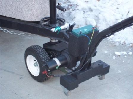

Very Nice Job.  I have been looking for a reasonably affordable electric dolly like the one you are using in the pics. Can you tell me where you got yours and the make and model?  I have a narrow driveway that i need to walk our pod down with the dolly.  Thanks!!
Jackdaddy
Posted By: marwayne
Date Posted: 30 Apr 2014 at 4:39pm
How is this for narrow.
The dolly I build myself.

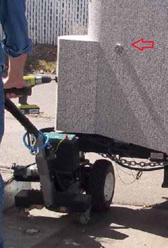

marwayne, your nose job looks like an interesting addtion, def helps to solve the problem of having too much stuff!  Quick question, I saw your drill sticking out of the tounge jack, how did you do the conversion?  The only thing I have found so far is to cut off the handle and weld a head on that your drill will take, but I dont have ready access to a welder, so was hoping for a "quick fix"...
Thanks!
Bobby
Me, the Wife, 3 Kids 5 and under...its Crowded!
2014 RP-178 HRE
2017 Expedition EL 4WD
Posted By: marwayne
Date Posted: 01 May 2014 at 11:16pm
When I cut off the crank I left the nipple as long as I could cut a thread on it and put on a long nut.(don't know what they are called) I then filed a small section of the nipple flat and put a setscrew in to the nut. see pic.

Bred, I started out with a dolly from princess auto, they have them on sale every once in a while for 300 or 400$, it may do the job for you. My driveway is to steep, the way the dolly is built it didn't do the job for me so I rebuild it.

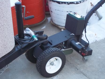

Something to consider: scrap the little battery and add a spring coil cord temporarily attached to the top of the jack, the plugged into the Bargeman for power.  One less battery to maintain for something rarely used.
Posted By: marwayne
Date Posted: 04 May 2014 at 4:53pm
Doug, I took care of that with a plug under the cap. I will use the plug when the little battery gives out.
Posted By: techntrek
Date Posted: 04 May 2014 at 7:30pm
That will work.
