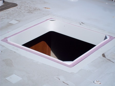

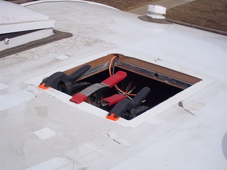

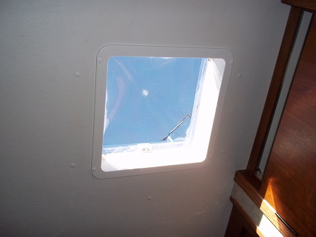

AC is out skylight is in.

I love it, we have real sunlight coming in to the pod.

I have bad news for you. The opening for the AC is 14 1/2"x 14 1/2" but the ceiling is 2 3/16" thick, in order to have a good overlap you need a 18"x18" skylight. The only Skylight in that size is either white or smoked, I wanted clear. The cost to have one custom made is between 250-300$ here, to much for me.
So I bought a clear cover for the fantastic fan, I build my own curb and put a latch on it so I can open it for cleaning. I also fit a flat piece of plexiglass wish is laying on top of the inner trim. It is kind of double glass.

What material did you use to make up the Curb?
