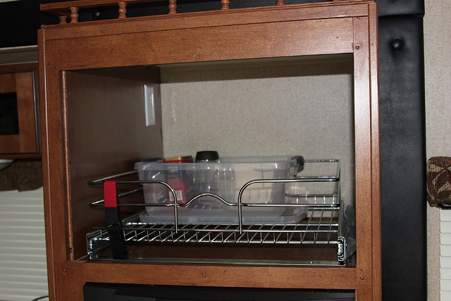

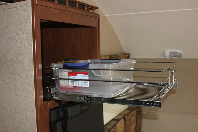

We have a 177, and I agree with you about the kitchen storage...not well thought out and minimizing what you carry only gets one so far.  We camp almost exclusively off the grid, so I removed the microwave/convection oven and installed a pull out wire rack in that large cabinet space...made life much nicer for us.  Now the pots and pans are off ground.  I can store some dry goods on the same shelf, and keep the back up foods under the dinette.  Of note, I also created additional storage in the drivers side of the dinette which is not there when delivered from the factory.

Two pictures of the rack.  In the retracted position you can see I installed a velcro strap for retention of the rack when traveling.

Nice job on the mod. I'd love to see the under dinette seat mod.

Allan7170: love the rack! I too never plug in so micro is storage.  In as much as I have not taken the leap of faith and done same, where did you get the rack?

Rack is from Lowes...but Home Depot sells similar products as do many other kitchen supplies.  they are standard sizes.  Even bed, bath and beyond (pricey, though)...
FYI, once you pull the microwave, the inside of the cabinet is already finished.  So all you have to do is touch up in a couple places with stain, fill the 6 holes that secured the micro and the space looks nice.  You will need to reinforce the underside of the cabinet bottom where you screw it down, but that is very simple.  Mine was done from start to finish in an hour.
