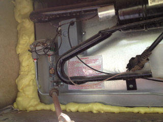

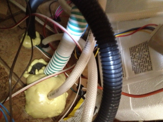

It sounds like you are experiencing the problem we had with our 2012 model 173 the first time we used it. We bought it new in October last year, and went camping that month. The night time temps got low, and our furnace only turned off for a few minutes at a time. It was working way too hard, and we were still not warm. It turned out that the whole camper had not been properly sealed at the factory. Our dealer did a rather thorough and extensive job of sealing many areas with foam, and sent pictures of the original lack of sealant to Forest River. The difference was like day and night. Now, our rPod warms up and cools down easily, like such a small camper should. Before the sealant was added, our rPod furnace was trying to heat the great outdoors, and we would never have been happy with the camper. The work was done under warranty.
We have only used the A/C since the dealer sealed things properly, and have been quite satisfied. We camped under extremely warm and muggy conditions the last time out, and the only place we could get comfortable was inside the rPod. It's a small space, so the A/C and furnace fans do seem loud; but they are actually a little quieter than what we had in our last camper. I don't think we have experienced the thump sound that you mentioned when it turns on, though.
One "problem" I did experience with the A/C was that the fan kept running constantly, and it was annoying the heck out of me. It seemed to me that it hadn't done that on a previous trip. Then I discovered that there are two settings for the fan at the thermostat: ON and AUTO. I must have inadvertantly set it to ON, and when I switched it back to AUTO, all was well.

Posted By: sammycamper
Date Posted: 26 Aug 2013 at 5:43pm
Hogone,
The worst areas were around the refrigerator and the hoses to/from the hot water heater. You can see in the first two pictures, taken from the back of the refrigerator, where the dealer filled significant spaces with yellow foam. The third picture shows the hot water heater area. They also installed foam around the vent openings.
Basically, anywhere that there is a hole or cutout through the wall, floor, or ceiling of the camper should be sealed. That wasn't done by the factory, and the air leaks made our rPod virtually impossible to heat. We could feel a significant breeze next to the refrigerator that first night out, and I stuffed paper towels between the fridge and the wall inside the camper to slow it down temporarily.

Date Posted: 27 Aug 2013 at 9:32am
Wow, thanks.  I'm going to do a better inspection.
