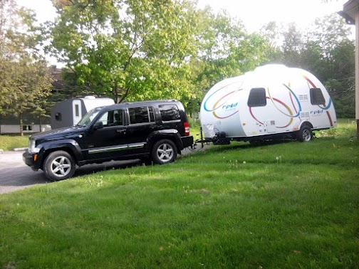

I was resetting up my Weight distribution Hitch yesterday because I had put the axle risers on and it changed the height so I had to reset it. I was taking some pictures that I think really show why I like using the WDH. In the picture below before I put the bars on the WDH you can see the slightly nose up attitude of the Jeep. This takes some of the weight off of the front wheels and in high wind or wet conditions the nose of the jeep moves around.
In this one with the bars on is sits level putting the weight back on the front wheels and giving more control.  I measured it and the difference is 1 1/2 inches on one side and 2 inches on the other.

At least in my case, I have found that too much weight distributed to the front can have an even worse effect on the rear... Even one extra link makes the back end of my trailblazer want to float around. I'm considering upgrading to a Tundra or Titan sometime next year.

Yes you can transfer two much weight to the front and the shorter the wheelbase the greater the risk of this. I try and set my WDH so that there is no lift on the front but no compression either. I am  using an E2 Hitch witch has solid brackets instead of chains to attach the bars to the tongue. The instructions on setting it but warn about the danger on putting too much weight distribution into the hitch.

Yes, the E2 instructions say that its better to leave some sag in the rear if necessary to keep from unloading it too much.

Sorry... iPad went nuts... That makes sense, as the wheel base on the TB is fairly short. My WDB are now set to allow just a little sag in the rear. Still trying to feel my way along.

What my pictures don't show is that normal the stance of the liberty is nose down so when the
Jeep looks level it's actually a little down in the back.

Place your tow vehicle on a horizontal flat surface.  Measure and record the height from the ground to the top of your wheel wells.  Attach the WDH and allow the 'fully loaded' Pods weight to press down on the rear of the TV.  Measure and record the heights again. Adjust the 'trunions-rods-bars" as suggested by the WDH instruction sheet.
You don't want the front end to be depressed any more than you have raised the rear end.  So if the rear of the TV is lifted by 2 inches...the front should have been lowered less than that (maybe 1.5 inches).  This way the front is not depressed too far out of alignment with the rear. Readjust the distribution one way or the other, if you need to raise the rear farther or lessen the weight on the front. As mentioned in the comments...you don't want to put too much adjusted weight on the front suspension.
