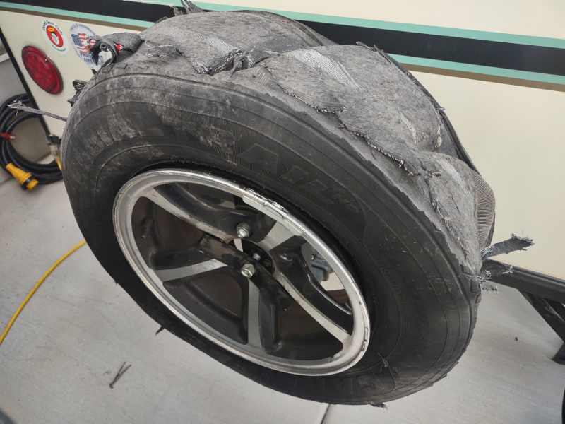

Stephen, I'm curious about the tire blow out. Was it excessively hot at the time of the tire blow out or do you attribute it to a specific road hazard or possibly tire age? Were you employing a TMPS? Glad you are ok. ~PP
Portage, MI — 2017 RPod 179 - sold / 2017 Toyota Tundra — https://johnmarucci.com/r-pod-video-list/ - My RPod YouTube Videos
Posted By: StephenH
Date Posted: 30 May 2022 at 11:23am
I do not have a TPMS system for the trailer. I don't think it was excessively hot since we were still at a significant altitude (which would have increased the pressure differential between inside and outside the tire but I don't know if it would have been that significant). I had noticed that that tire had wear on the inside edge and would have probably replaced it when we got to our daughter's house if it had not blown. I probably should have switched it out with the spare which was in new condition with no road miles. Of course, hindsight is always 20/20. As far as I know, I don't recall any road hazards. that does not mean that there was not something that contributed to the failure that I did not see.

I'm glad I keep my speed at 60 mph or lower (with rare exceptions on steep downhill runs). I would not have liked to handle that at 70 or 75 mph. Even with the blown tire, the RPod tracked well. I don't know if the Hayes electronic sway control activated. That may have helped also.
Here's a picture of the tire:
