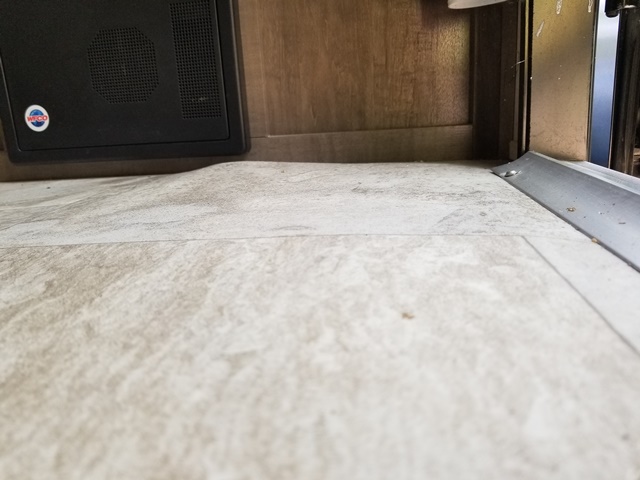

My husband Tony came to this forum often for advice. He passed away in 2021 and I’m trying to continue our camping adventures. So now I need advice. The floor in our 180 has raised up into basically a hump width wise from under the sink and stove (slide) across to under dinette. The slide drags so bad you can’t open it without bending the the bottom of cabinet. I took it to dealer and they seem to think they can fix it so I’m waiting for them to let me know if they really can and if they can tell what is happening. So I’m asking if anyone has had this problem and what they did about it. There is no extended warranty. Not sure I could make the case with Forest River about it. Any help or suggestions would be greatly appreciated!

Given the slide is scraping when coming in, it seems like a missing outrigger issue that is common on the R-Pod slide walls. Your slide wall is actually lower than it is supposed to be. Likely outside and under the slide there is no support to the wall where Forest River failed to add the proper outrigger metal supports. There are several threads on this forum on the outrigger issue if you use the search function. Others here can also speak to the issue.
Portage, MI — 2017 RPod 179 - sold / 2017 Toyota Tundra — https://johnmarucci.com/r-pod-video-list/ - My RPod YouTube Videos
Posted By: tony rpod 180
Date Posted: 24 May 2022 at 9:25pm
I think I understand what you’re saying on that but would that cause the raised hump all the way across the floor?

That is likely a bolt that secures the floor to the frame coming up through the sagging floor.

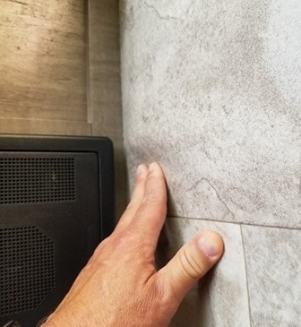

I think I have the same issue. I have a 2018 RP-189 and on my last camping trip I discovered the floor bulging up (1") about 6 - 8" from the doorway and the stairs are drooping lower than they had. I can see a distinct corner of something pushing the floor up, more on the forward side but both sides have issues. I was going to try and lift the vinyl flooring to look at what is going on but wanted to search this forum first. I have photos that show it but I'm not sure how to add a photo.
If anyone has any ideas, please share. Thanks
2017 Chevy Silverado 1500 4X4
2018 R-Pod 189
2013 Yamaha FJR 1300A
Posted By: ZuBrew
Date Posted: 22 Aug 2022 at 4:47pm
I figured it out. You can see the vinyl is lifted where I push down

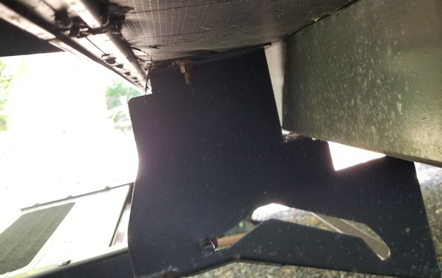

Offgrid thank you for the info. I went under my trailer and looked things over; the frame, axle and mounts are all in good shape. Nothing broken or bent (I ran a string along the frame & the side wall). What I did find is the portion of the floor that sits beyond the frame has drooped nearly 1" along the both sides. It's more severe away from the corners. This has also caused the stairs to pitch downward and they're very spongy. I haven't torn anything apart yet but I think most of the floor will need to be replaced.
My dealer (Couches RV Nation) doesn't want to here about it. They just informed me it was out of warranty which I already knew. Do you think I'll get anywhere if I contact Forest River? I'm not sure how to go about that yet but I'll start with their website.

Ok, good, you don't have a bent frame. The axle should be crowned a little (about 1/4 inch) in the center if you run a string line along the bottom of the axle from side to side. If it's flat it's bent.
Looks like you have a bad case of the infamous rpod outer floor sag. The floors are just two layers of lauan plywood with foam in between, and they cantilever outboard of the frame tubes, with the outer walls resting their weight plus the weight of the roof on the outside egdes of the floors. Not a very robust design, to say the least.
What I'd suggest next is to see if there is any moisture in the floor. You can get a wood moisture meter from Amazon for about $20. Poke the pins into the upper and lower lauan sheets and see if it's wet.
If it's wet you'll need to pull up the floor and dry everything out. If it's not wet then you might try jacking up the sides one at a time in several places. See how close to level you can get it. If it's pretty close (say 1/4 or so) and cosmetically acceptable to you then you could install outriggers to support the outer edges of the floor/walls, and call it good.
The outriggers carry the loads back to the frame. FR sells the outriggers because this is an well known problem, or you can fabricate them yourself. Lots of posts on this here if you do an advanced search.
I'm not saying you shouldn't try FR and see what they might do for you. They are well aware of the problem so if it's not wet (water damage is always the owners fault for not maintaining the seals) you might get something out of them. Good luck!

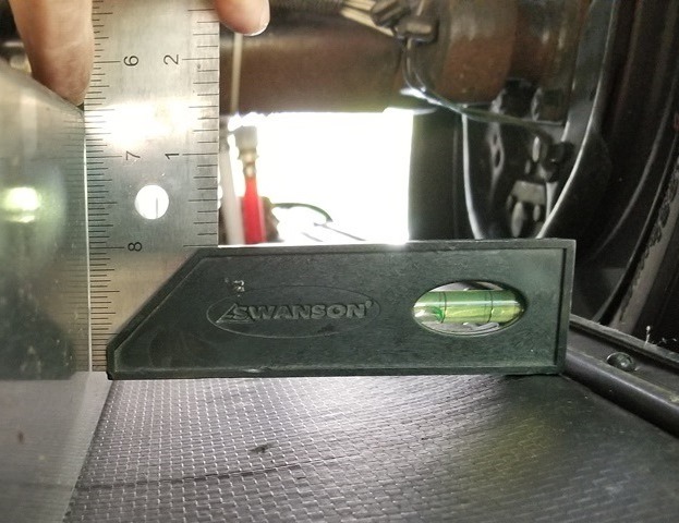

UPDATE; I reached out to Forest River and received an email back from Tina in their warranty department. She asked me to send her photos;
• interior area where you are having an issue – 2 to 4 different views – (w/ 3’ level on the floor in the sagging area)
• exterior area where you are having an issue – 2 to 4 different views – (square level butted up to the frame - include the front and rear view of the axle in photos)
• 4 sided view of your coach (make sure to get closer to the wheel and wheel wells in the side photos)
• your towing set up (hitch set up, hitch, if WDH need the rating, and tow vehicle )
I put several photos with descriptions in PowerPoint along with my truck and hitch details and sent that to her. Now the waiting game until I hear if they're going to help me or not.

For those that don't need to see the details and don't want to scroll.
2018 Rpod 180 - new to us in May 2021

My Rpod was returned to me this week. All fixed and looking pretty good except they didn't clean up their work mess. I had many dirty finger prints from the workers all over the inside and dirt on all the horizontal surfaces. Not that big of deal, I cleaned it all in an hour.
They replaced my axle, installed the outrigger brackets (only 2 on the slide out side), replaced the floor, the rear stabilizer jacks and they replaced both side walls. The floor feels much more solid. My stairs don't flex anymore, they're solid. I was surprised they didn't install the outrigger brackets on the right side of the camper. Everything looks straight, square and solid but I'll keep and eye on it. None of my modifications were an issue. I had modified the plywood under the mattress, adding a piano hinge to access the water pump and valves easier. When I lifted the mattress I found they hadn't installed any screws to reattach the plywood. This isn't an issue, I have screws I'll secure it with. They replaced the sides so they had to install the decals again but we didn't get the frog in the canoe decal. Not a big deal but I liked the Frog.
Overall I'm happy with all the work and can't wait to get out and camp in it.

I have 2018 R-Pod 180 that appears to be having the same saggy floor issues, which appears to be getting worse.... It sounds as though FR is aware of this issue on certain model years and are willing to fix it, correct? Do you have a contact person at FR?
Thanks Smile

I also have a 2018 R-Pod 180 and over time I have noticed that the floor is dipping behind the axil.
based on previous posts on the forum, it sounds as though FR is aware of this issue with these models and is repairing them..?
