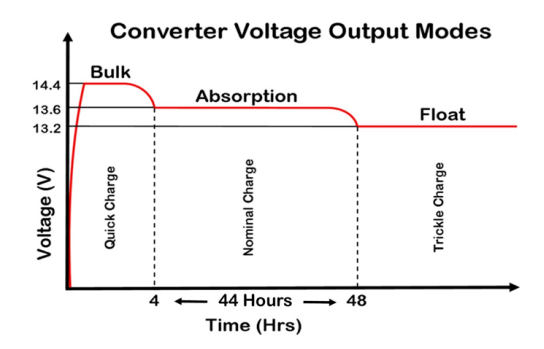

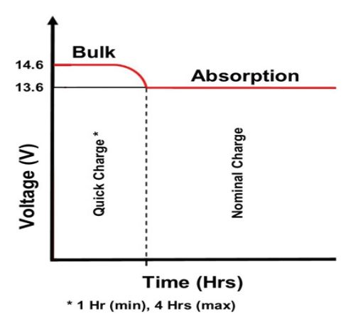

I looked at the charging profiles for both the WF-8735P and WF-8735AD and the three-stage profile is the same on both.  It seems that this would be safe for a Li battery, just not optimal, which would allow me to safely run the WF-8735P with the Li battery.  Here's what I'm basing this on:
More in the AD manual  https://wfcoelectronics.com/wp-content/uploads/woocommerce_uploads/2021/09/AutoDetect-8700-AD-Series-ManualCaHit-lma8e2.pdf - here .

Generally speaking, Li batteries don't need a multistage charging profile, unlike lead acid batteries. PbA batts do because their internal resistance increases dramatically as they near full charge, so you have to taper the current to get them there. They also need a small continuous (or at least frequent) float charge current or they will self discharge and the individual battery cells will become imbalanced. The continuous float charge corrects this by slightly overcharging some cells, allowing the others to get to full charge. Finally flooded PbA's need an occasional equalization charge at a highrr voltage to mix the electrolyte, which tends to stratify (sulfuric acid is heavier than water) otherwise. Simply put PbAs both tolerate and need some overcharging to perform properly and last.
OTOH, Li batteries can simply be charged up to a set voltage and stopped unless you are trying to recharge them at a very high rate (like in an EV fast charge station). It is harmful/dangerous to charge Li batts higher than that. That means a different approach has to be taken to assure cell to cell balance another approach is needed. This is an electronic cell balancer which should come integrated into any Li battery you buy. These usually (but not always) also come with a high voltage cutoff to prevent overcharging in the event your charger malfunctions. Some also monitor battery temp and limit charging when the battery is too cold. So simply put Li batteries don't tolerate or need overcharging.
I'd suggest that you let the charging revommendations spec'd by your battery supplier set the direction you take for the charger(s) you get.
