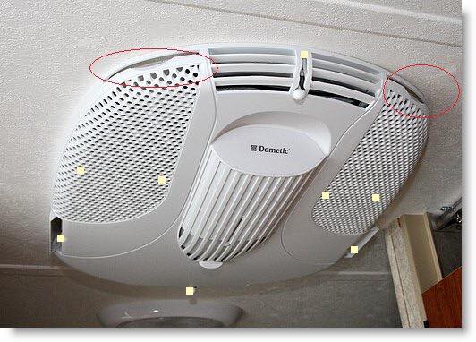

Can one one tell me how to remove the inside cover, I can only see to screws which I removed but could not remove the cover.
Posted By: StephenH
Date Posted: 03 Aug 2021 at 9:02pm
There are at least 8 if I remember correctly. Check behind flaps and look in the circular holes with a flashlight. You will find them eventually.
Posted By: Harry & Lizanne
Date Posted: 04 Aug 2021 at 8:30am
Thanks
Posted By: marshel
Date Posted: 04 Aug 2021 at 9:24am
You have to remove the filters to access some of them:
