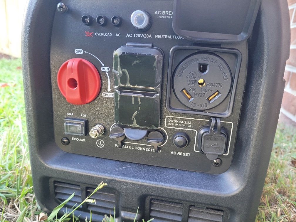

Posted By: pedwards2932
Date Posted: 23 Sep 2021 at 2:51pm
Well the gen set had the proper plug in for the 30 amp cord so no adaptor was needed.  I was able to get the AC to start up 3 times with no issues.  One question do you need to take a spike and connect it to the gen set ground mine has a connection that says to externally ground.  Reason I ask is when I connected my surge protector I didn't get a blue light that would indicate it was grounded?  I will try to post some pics when I get a chance but is seems like this is going to work.  As with others it is pretty quiet on eco but louder when off and running the AC.....but 60 lbs and I got it for $460.
Posted By: StephenH
Date Posted: 23 Sep 2021 at 3:56pm
Most, if not all, generators of this type have what is called a "floating ground." Even if you drive a ground rod, you may have this. What you need is a Bonding Plug. You can purchase them, or if you want, you can easily make one.
Parts needed:  One male grounding plug such as this one from Lowe's or Home Depot:
https://www.lowes.com/pd/Hubbell-15-Amp-Volt-Yellow-3-Wire-Grounding-Plug/3739251 - https://www.lowes.com/pd/Hubbell-15-Amp-Volt-Yellow-3-Wire-Grounding-Plug/3739251
Short length of AWG10 or 12 wire, 10 preferred.
Sealant for hole if desired
Directions:
Open the plug.
Identify the terminals. Brass color is the hot wire, silver the neutral wire, and green is the ground wire connection.
Cut a short length (as in a couple of inches) of wire. Strip enough off of the ends to connect to the terminals.
Connect one end to the neutral (silver) terminal.
Bend and connect the other end to the ground (green) terminal.
Close the plug. Add sealant to the open hole to seal it up if desired (I did).
When the sealant is cured, it is ready to use.
How to use:  Plug this bonding plug into one of the 15A outlets. You will no longer have a floating neutral and your surge protector will be happy.
Why does this work? When you connect to a shore power connection, the neutral and ground are bonded at the breaker panel. When you plug into your generator, they are not bonded. The bonding plug does this so your power source is recognized by your surge protector to be set up properly.
Date Posted: 23 Sep 2021 at 5:23pm
And this will fix the ground on the 30amp plug as well?  Does this actually accomplish anything safety wise or will it just satisfy my surge protector?
Posted By: StephenH
Date Posted: 23 Sep 2021 at 5:35pm
You should still drive a ground rod for safety. This just addresses the floating ground.
It will also bond for the 30A plug. Simple surge protectors will only show a fault. Some of the fancier ones will not allow power to turn on if it senses this fault. That is the reason for the bonding plug.
Date Posted: 23 Sep 2021 at 6:03pm
I will probably not use the surge suppressor when I am running the generator but mine just showed a fault in the ground.  Not sure if the surge suppressor is necessary with the gen set.  Good news is it seemed to start the AC without a stumble or anything that I noticed.

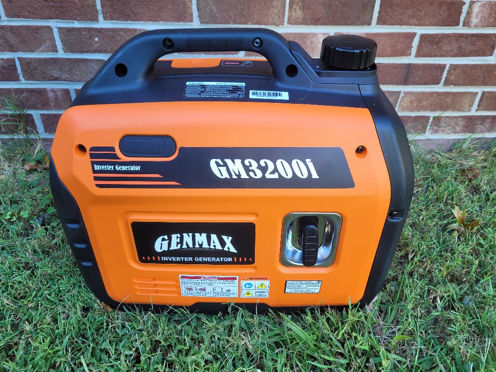

Date Posted: 24 Sep 2021 at 4:29pm
Here is a pic of the generator.  I am not endorsing this as I just got it and can only say it is lightweight and it was able to start my AC.  This is the actual company that built the generator's site:
https://www.cqdinking.com/pages/company-overview.html - Company Overview (cqdinking.com)
This is their various generator invertors:   https://www.cqdinking.com/products/collections/quiet-inverter-generator.html - Quiet Inverter Generator (cqdinking.com)
Whoever imports it has them put the Genmax name on it.  The price went up to $549.  I got coupon for 50 off and it was 499 so I paid 460 total
