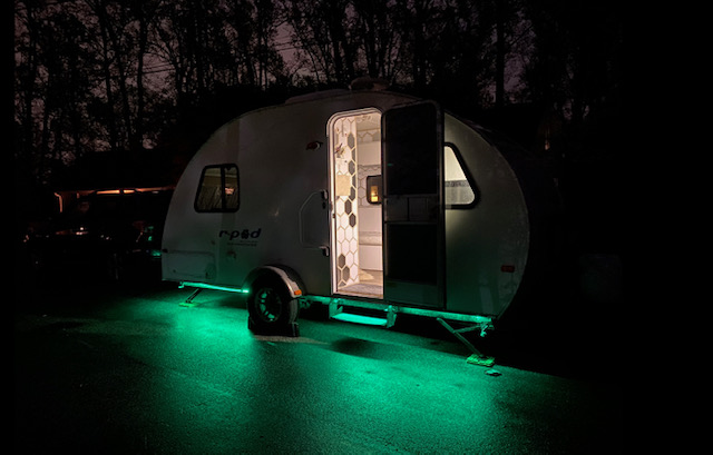

Posted By: TeamRPod
Date Posted: 12 Apr 2021 at 8:13pm
I figured I would post a picture before I damage the strip tacking it down proper. Yes that's a tupperware lid cough junction box cover on the ground.

Glad you got it figured out. Looks kewl.

Posted By: podwerkz
Date Posted: 13 Apr 2021 at 9:38am
That green LED glow just screams 'ZOMBIE POD'.....all you need is a few radioactive logos and you're all set!
Tongue
Posted By: TeamRPod
Date Posted: 13 Apr 2021 at 11:33am
Zombie Green (or Red) it shall be! As my blue lights only work up to the stairs where my strip light got damaged.
