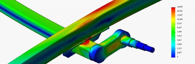

Back on the original "physics" question, the highest load on the rpod frame occurs just aft of where the axle attaches. The design safety factor for bump loads at that point is pretty marginal already. Hanging more weight off the rear of the trailer will make that worse. I'd recommend avoiding that if possible.

Posted By: lostagain
Date Posted: 01 Mar 2020 at 1:17pm
What happens to the stress analysis when you move the end of the axle further outboard from the frame, such as the actual distance found in the rPod?  How does that change the overall stress points?
Fred & Maria Kearney
Sonoma 167RB
Our Pod 172
Posted By: offgrid
Date Posted: 01 Mar 2020 at 6:07pm
Not certain I’m follow you but if you’re asking what happens if the frame rails are further inboard but everything else stays the same then the frame stress should be the same (the axle stress would be higher tho).
Date Posted: 01 Mar 2020 at 6:39pm
What stress colors would show on the frame & axle if the axle was extended further outboard from the rails, as is the case with the r-Pod?  If I recall correctly, the axle, between the frame rail and the torsion arm is in the ball park of about 8", which would appear to be quite a bit further than exists in the your stress illustration.  Would that distance change the how the stress impacted the frame/axle assembly?
Sonoma 167RB
Our Pod 172
Posted By: offgrid
Date Posted: 02 Mar 2020 at 5:22am
It shouldn’t change the frame loads but a longer distance between the hubs and the frame attachments certainly will increase the axle loads.
